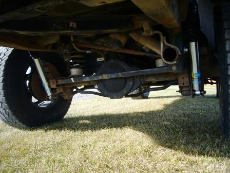

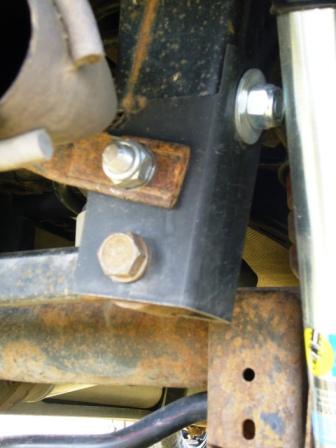

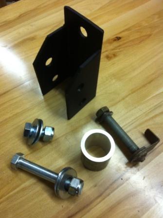

Panhard Bar Extension - rather than extending the panhard bar I chose to build an extension to lower the mount.
Attached is a pic of the mount installed and the disassembled components.
The mount is 3" x 4" x 3/16" tube. The 3" width fits the frame mount snug.
I used 16 mm hardware through out.
I had an aluminium heavy wall tube I used as a spacer for the stock mount location. A smaller solid spacer would be more appropriate but this worked.
In my case with Mark's 3" suspension kit, the rear was raised 2" so I lowered the mount hole by 2". The mount is angled so the mount hole is 1/2" off set to the outside.
The panhard bar is close to horizontal.
Panyard Mount Extension.jpeg (20.49 KiB) Viewed 21429 times
Panyard Bar Horizontal.JPG (37.61 KiB) Viewed 21429 times
Panyard Bar Extension.JPG (28.2 KiB) Viewed 21429 times

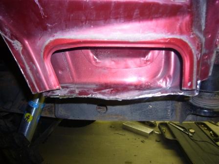

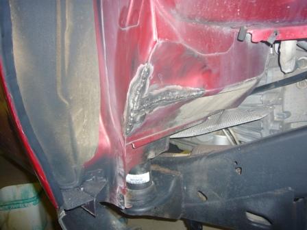

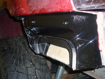

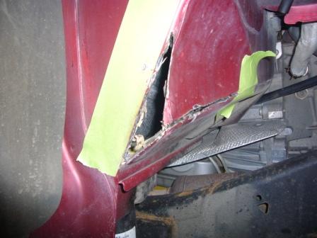

Front Wheel Well Mod
Well Cut out.JPG (29.02 KiB) Viewed 21090 times
Welded Fender Well.JPG (28.73 KiB) Viewed 21090 times

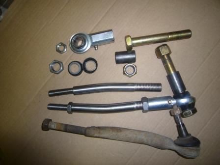

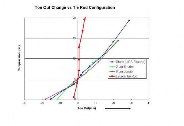

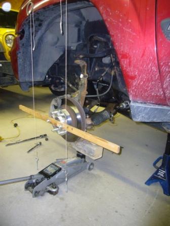

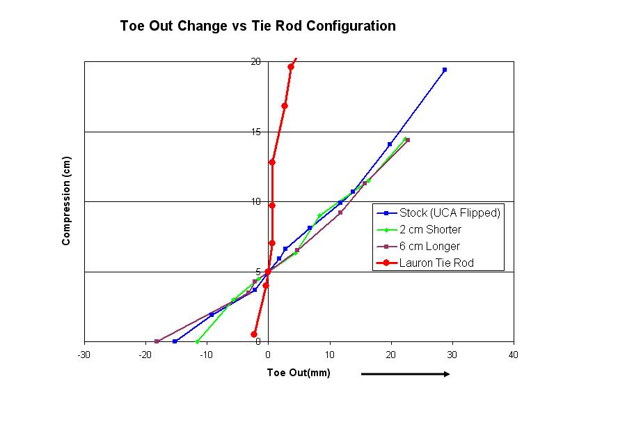

Bump steer measurement and tie rod components
Bump Steer Measurement 1.JPG (30.4 KiB) Viewed 21090 times
Tie rod components.JPG (24.44 KiB) Viewed 21090 times

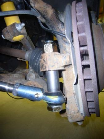

Installed Tie rod

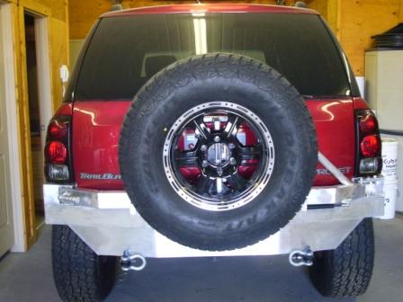

This build has taken way too long but now that it is done, all except for a license plat mount and light, I am pretty happy with it. Too many details to show in one post so it will take a few.

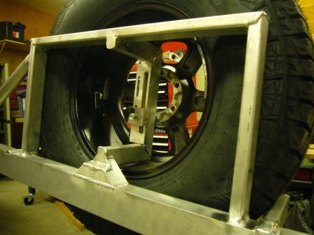

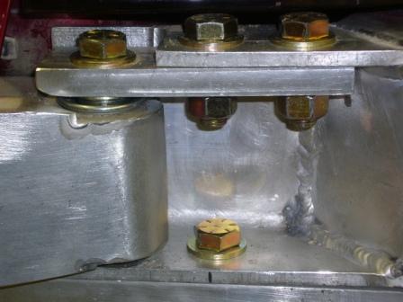

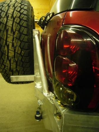

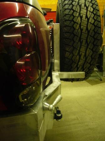

Bumper:
6" x 2" x 1/4" channel on Bottom - 2" angle welded and bolted to bottom of channel is bolted inside the frame tube
two rows of 4" x 2"x 3/16" channel on top - an additional 2" angle is bolted to the channel flange back to the inside of the frame( picture to follow)
The channels bolted together with 1/2" Grade 8 Bolts on the flanges
Tire Carrier:
3" x 2" Tube 1/4" wall end pieces, centre tube is 3/16" wall
1" by 2" x 3/16" wall Frame
Tire Mount:
1" x 2" Tube cut out to accept 1/2" Bolt
Long hex Bolt with hexed locking plate
Tapered washer for bolt head in wheel stud hole
Opening Spring: gas spring 100 lb load ( I could have gone lower. This spring will whip the carrier open fast!)
Hinge and latch coming next

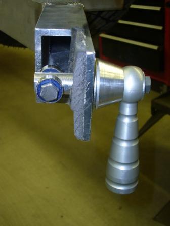

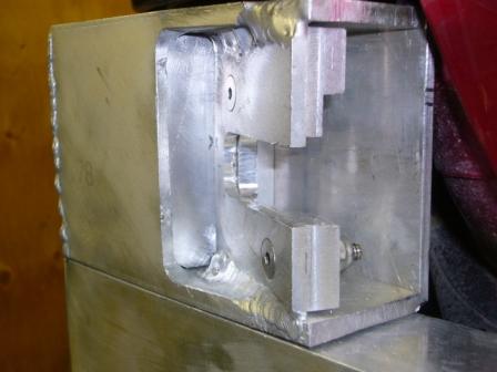

The Hinge is a 1 3/4" aluminium bar drilled with a 9/16" hole to accept a 1/2" Grade 8 Bolt. I folded the sides of the cut out 3" tube and welded the tube to he bar. The bar and tube was then machined to accept 1/2" thrust ball bearings for a wheel barrow. The top mounting plated is slotted to adjust the height of the carrier to the latch.
The latch is composed of an extra handle from a Jeep build. I had to build the tapered spacer and the centre pivot to hold the dual sealed bearings. The bearings rotate onto dual ramps on to vertical notch to hold the carrier closed. The handle is vertical for the bearings to pass through the vertical slot in the latch plate.

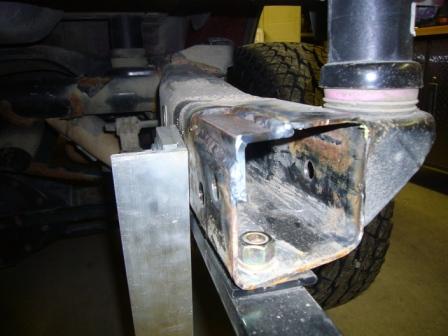

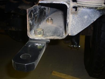

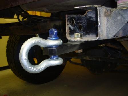

The Tow Hook: 1" x 2" bar drilled for 3/4" bolt holes and D ring
The Frame Cut out was from the Mark McMaster bumper mount. The slot was filled with the angle. The aluminium angle attached with a free non-rotating nut inside the frame.
Tow Hook.JPG (22.85 KiB) Viewed 20528 times
Tow Hook w D ring.JPG (24.9 KiB) Viewed 20528 times
Frame cut out fill.JPG (29.4 KiB) Viewed 20528 times

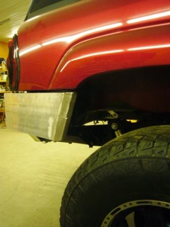

The bumper extends to the wheel well but is only 8" tall so the body would hang bellow the bumper. So I decided to cut them down. The passenger side pic shows the end result. The drivers side has the interior air vent which required the vent to be cut down also. The lower half of the vent was removed and the cut out modified and sealed. I pop riveted the sides and used body sealer inside and out and then painted. The vent is held in with double sided sticky foam tape.
