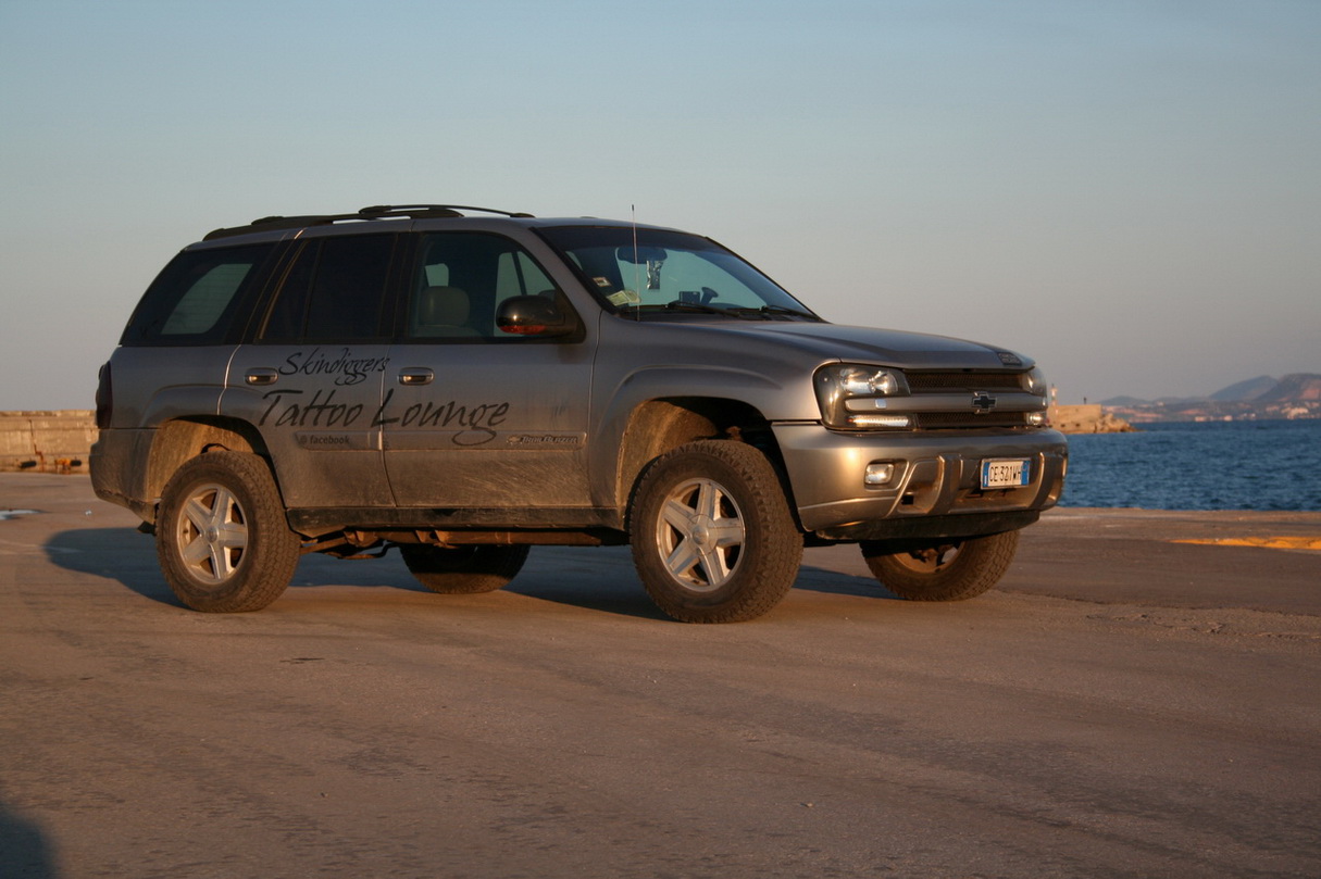

TrailBlazer LTZ 2003 /4WD /G80
Engine mods:
Catalyzer cut off
K&N air filter
Icom LPG system
Front suspension mods:
3" MarkMc lift
Bilstein HD struts
1,5" MarkMc wheel spacers
Rear suspension mods:
2,5" hand made lift spacers
Procomp shocks 2" longer
Tires
265/65/17 Goodyear
Exterior mods:
HID lights
side steps off
tinted rear windows

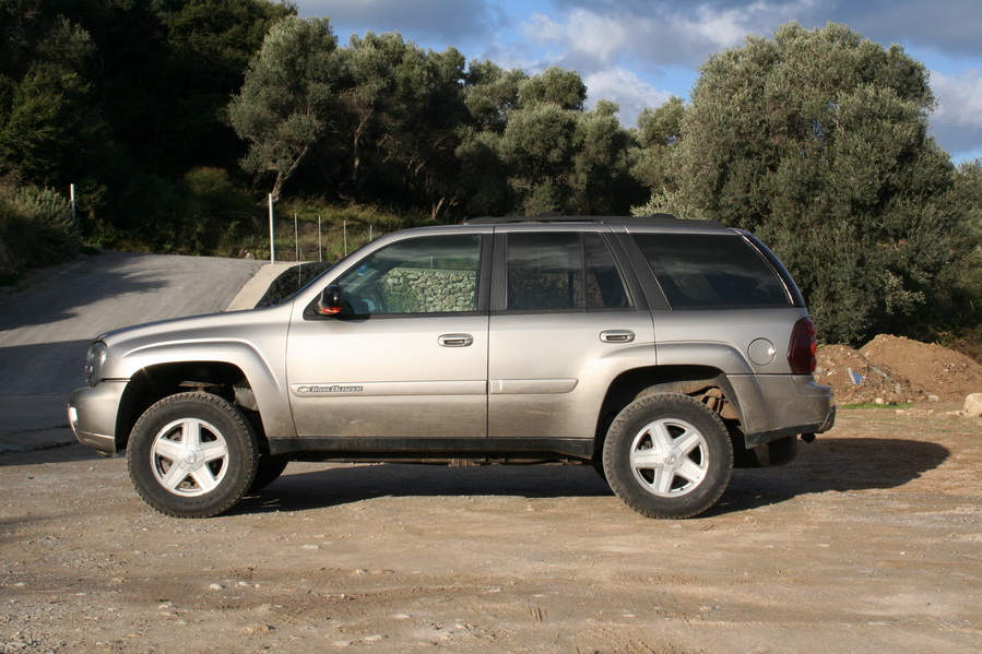

This is how it looks today..

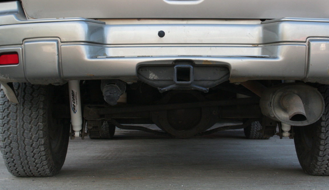

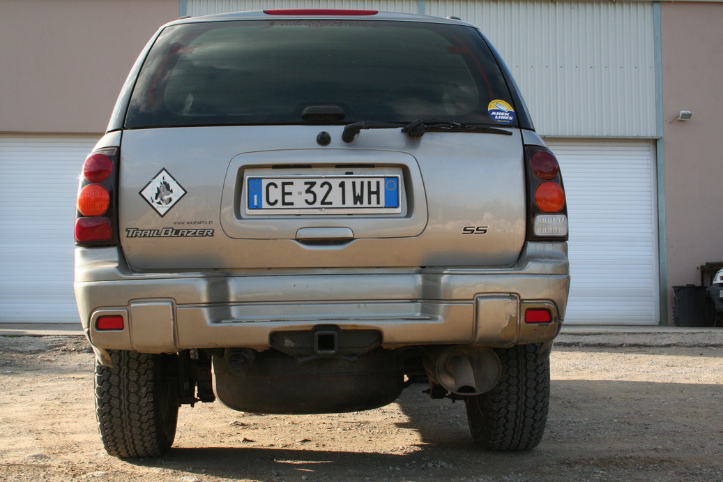

by Skindiggers » Mon Jan 23, 2012 4:35 pm

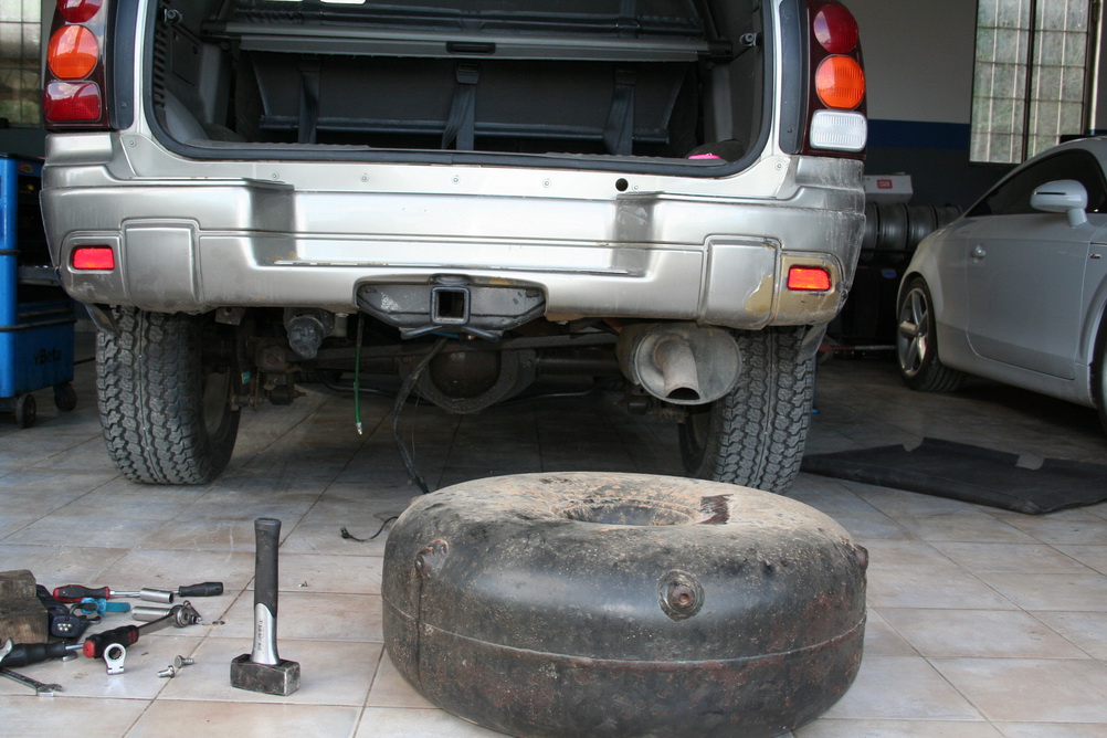

I bought the TB in 2005 from US , i shipped it to Italy and registered it there ( in that period i was living in Milan )... Just after that i installed ICOM LPG system , which was the most advanced LPG system , it delivers the gas in a liquid form (the gas stays in liquid form at -40 degrees Celsius ) in the engine and this will give 10% more power (3500 Euro including mounting ) . When they mounted the LPG tank they were not thinking that i might want to go off-road some day and they put it in the place of the spear tire , under the truck with 4 screws .This was not a good idea ... In the past 4 years i broke those screws several times . Than i mounted bigger tires with the idea of having more clearance for the gas tank 265/65/17 but i was still hitting the rocks with it and i realized that i need a lift kit . I made some spacer blocks from a special hard plastic to put them under the rear springs , 2.5" big and i made other blocks that i mounted on top of the front struts with the same height .. Immediately after i mounted the lift blocks i saw that the front cv joints where making noises when i was hitting bumps or holes in the road and i understood that i did something wrong . Than i ordered a 3" lift kit from MarcMc , wheel spacers , new Bilstein front struts , new rear shocks from Pro Comp 2" longer .. and thanks to Mark i ordered also other parts that i needed to change , like radiator , manifold , front diff left axle seal (this one i think that broke because of my hand made front lift that was allowing the axles to bend more than they should ) , filter and gasket for the transmision... All this parts are very expensive here in Europe and some of them are impossible to find so thanks again Mark for all your help..
In the mean time i took the gas tank from under the truck and i mounted it in the trunk , for even more ground clearance ...

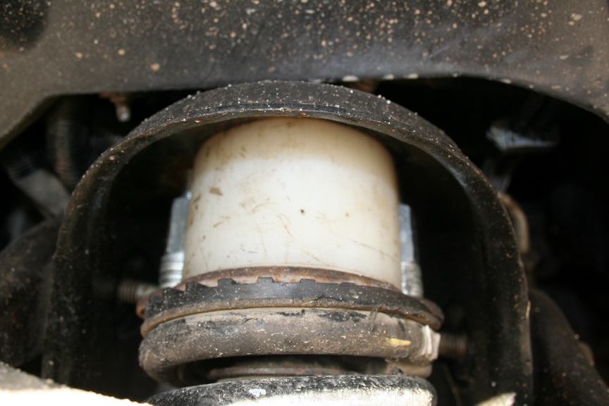

by Skindiggers » Tue Jan 24, 2012 9:51 am
this is how the car looked like with may hand made lift kit ..
This are my first front hand made spacers.

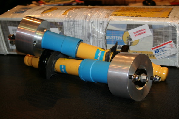

by Skindiggers » Tue Jan 24, 2012 10:19 am
The parts from Mark start arriving.. ,
Trailblazer 3 inches front lift kit.jpg (93.06 KiB) Viewed 19471 times
Skindiggers
Posts: 128
Location: Crete, Greece

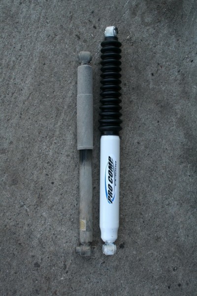

by Skindiggers » Tue Jan 24, 2012 10:26 am
MarkMc front lift and Bilstein struts mounted and tested..

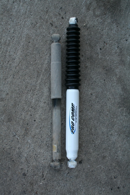

rear Pro Comp shocks mounted

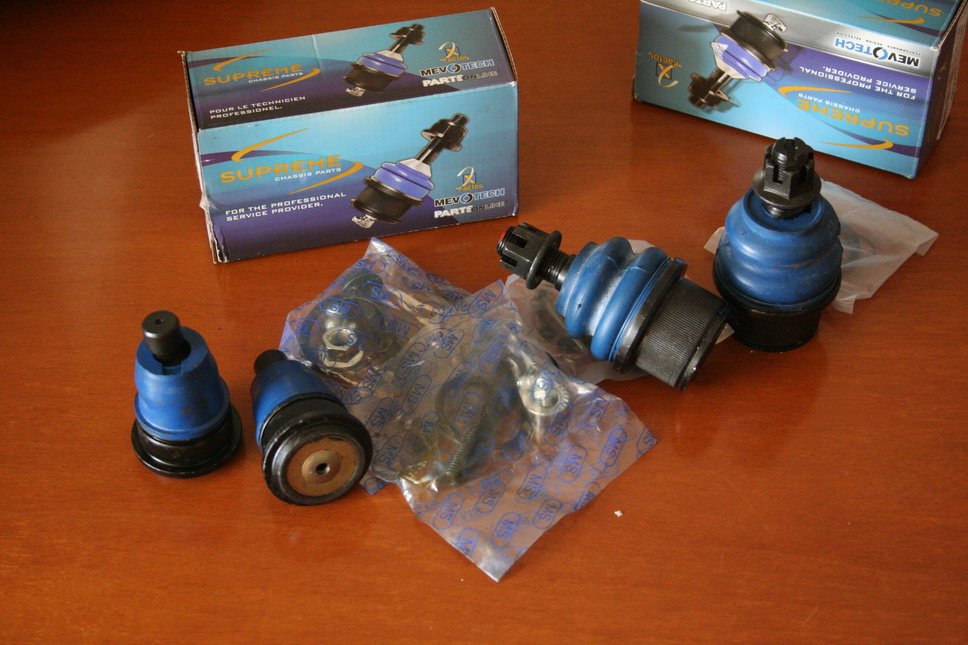

by Skindiggers » Tue Feb 07, 2012 9:36 am
Yesterday i received the ball joints from Mark..

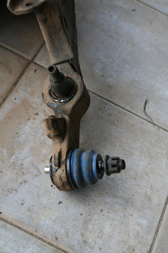

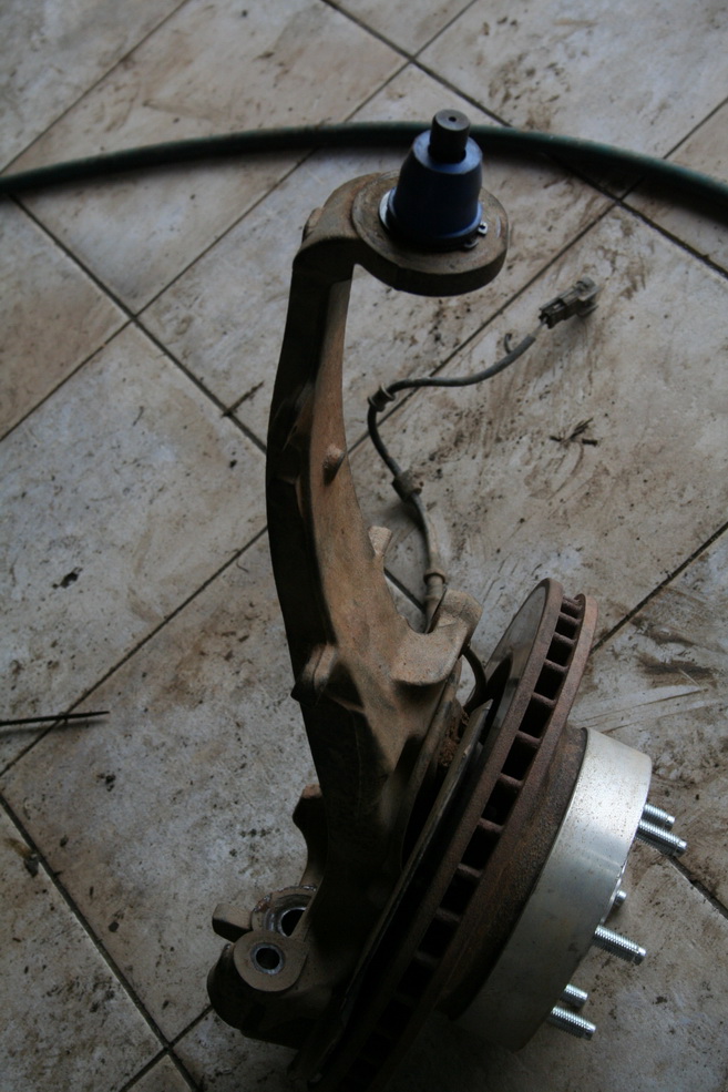

by Skindiggers » Tue Feb 07, 2012 9:47 am
This morning i changed the ball joints .

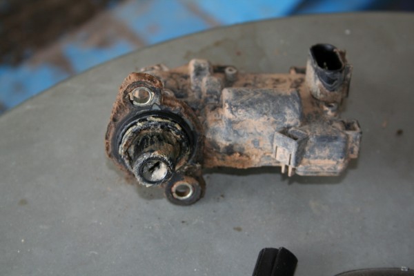

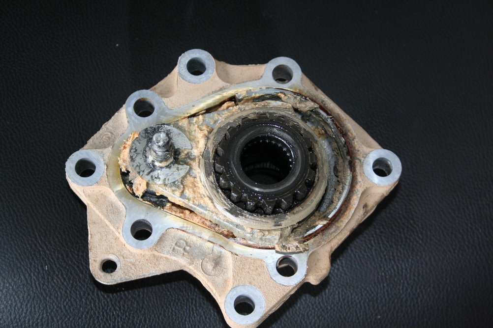

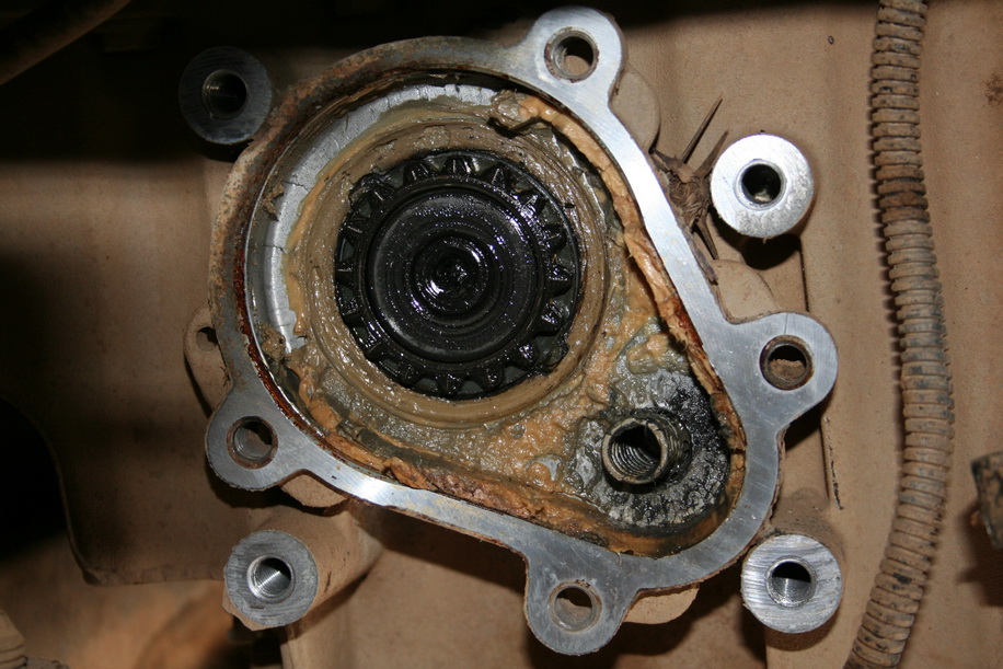

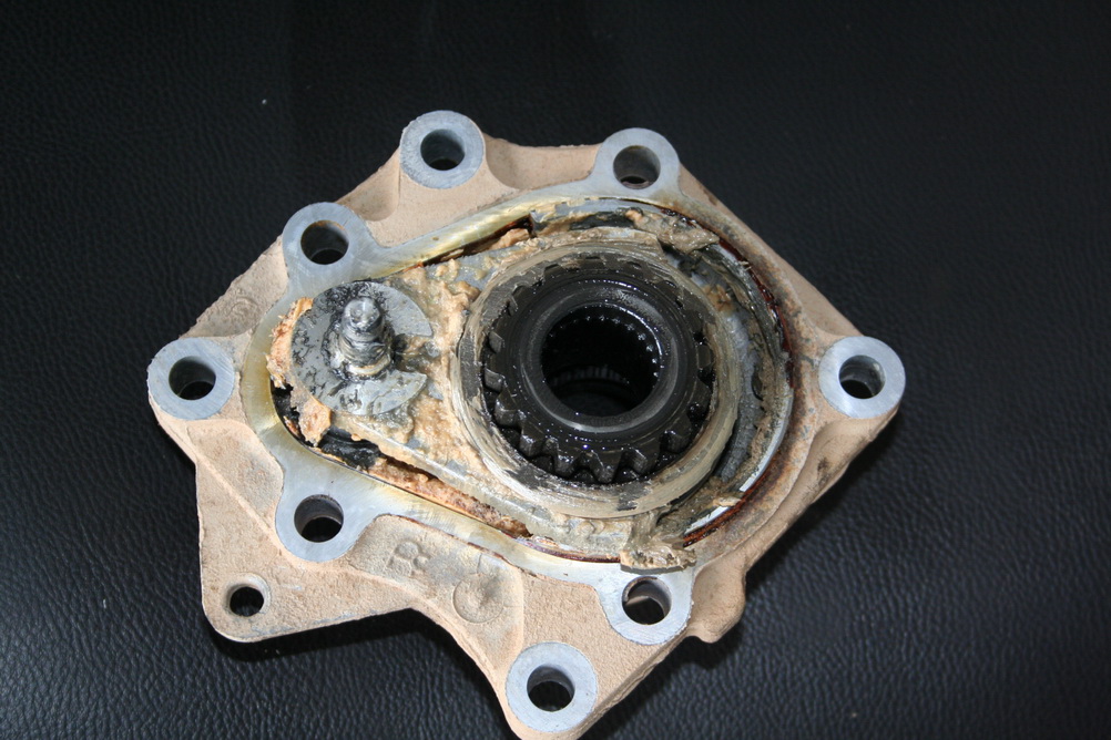

by Skindiggers » Tue Feb 07, 2012 9:52 am

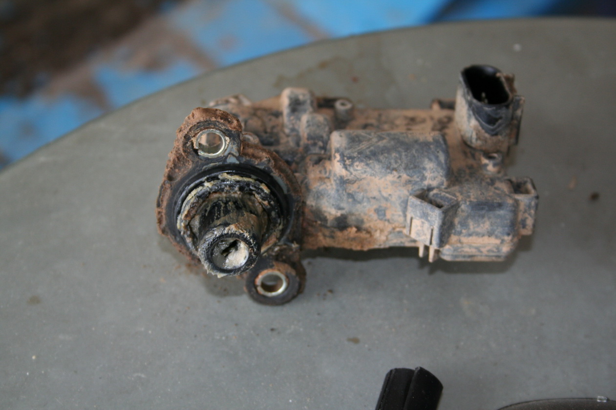

and i also opened the front disconnect to see the condition of it ! I think i can win a prize for best looking front disconnect .. the grease was still white , but unfortunately one ball bearing needs replacement so i will have to open it again soon ..
