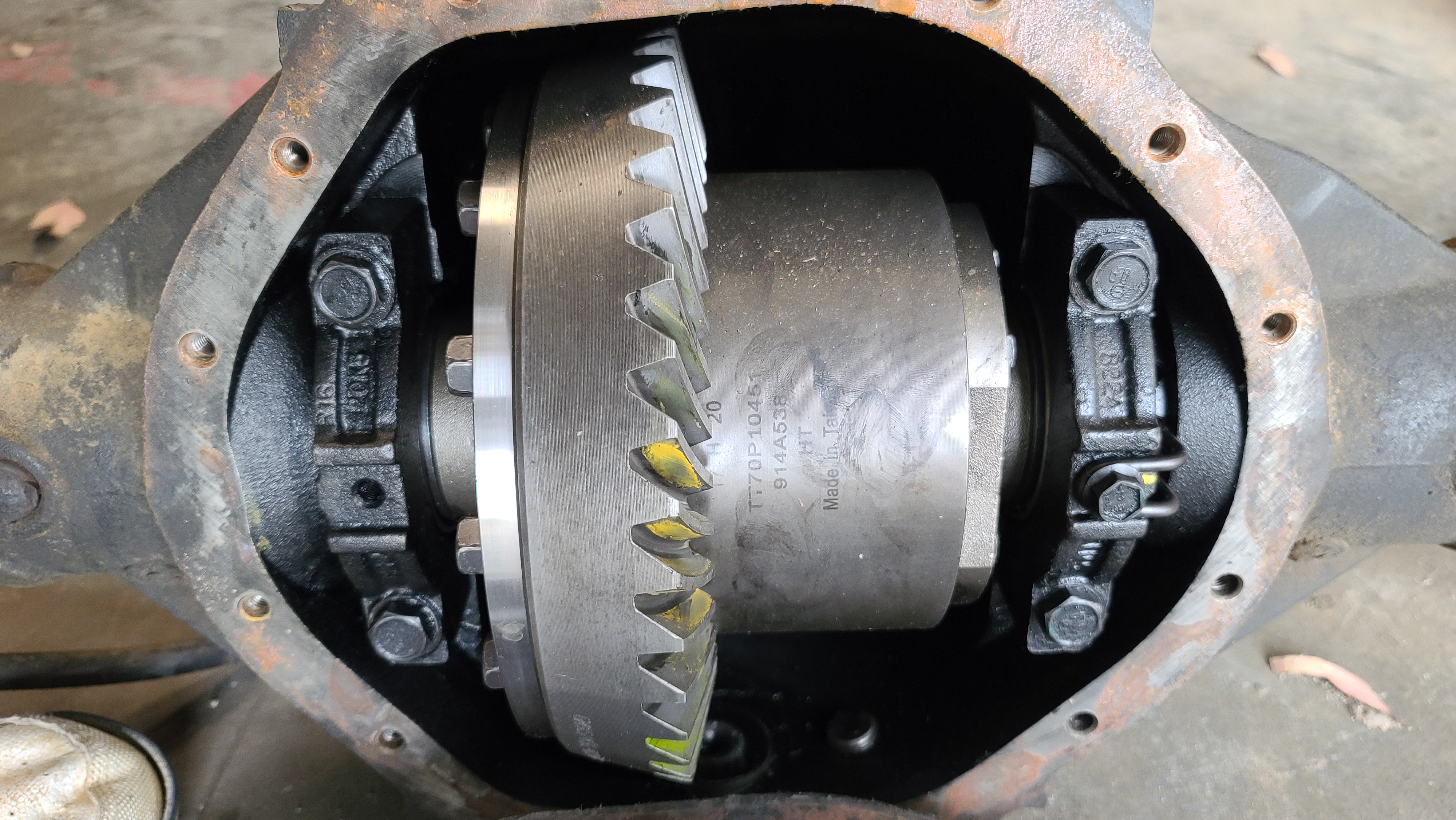

I've got a TruTrac in the Trailblazer. I really like it, but I also don't do gnarly things with the rig. Took it to Usal Beach in January and it didn't miss a beat.
The old G80 and 4.10s.
New Trutrac and 4.56s.
Stock 10-bolt 8.6 versus the 14-bolt 9.5.
All buttoned up.
Usal Beach
