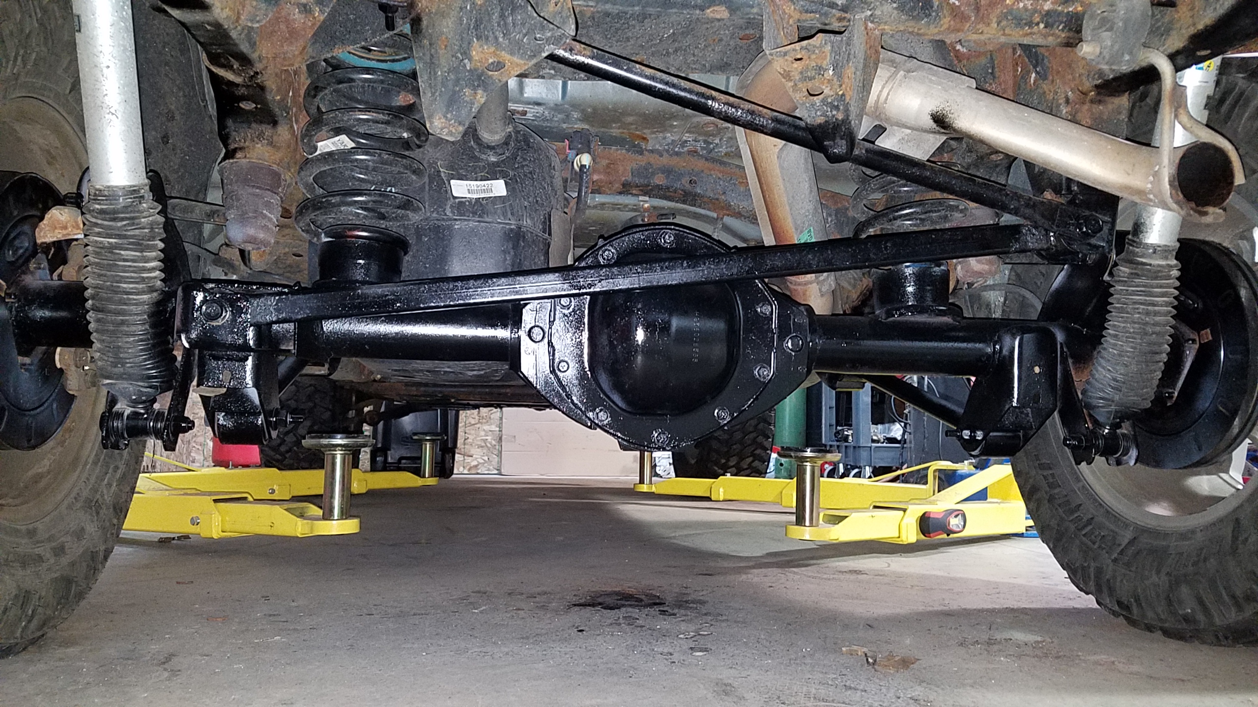

I'm doing this swap after work tonight. Just got thinking... will the driveshaft need to be a different length? I'm putting a 8.6 in place of the 8.0 in my SWB 2003... if I need something different for a DS I don't want to start the swap until I have the right unit or get mine shortened if that's what it needs
Yes, I did 4.56 gears and a Detroit truetrac into an 8.6. Reason being it was cheaper for the truetrack than the locker by a couple hundred and the street manners are better, which is where my rig spends 99% of its time.
How is it with the new setup. It's something i dream of doing but always fear getting stuck with the g80. Just did a drain and fill last weekend and all the bolts were siezed anyway.
