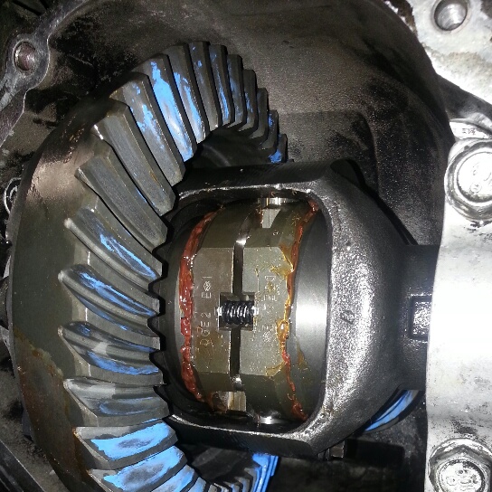

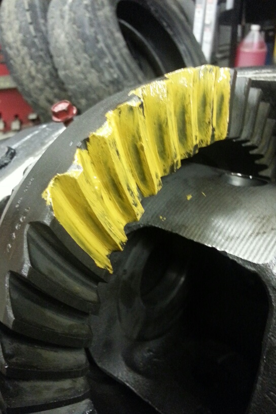

Ok so here's my situation I installed a lowmile 8.6 and before I drove with it switched the gears from 3.42 to 4.56 I ran it for about 500 miles with just the original spider gears in it I had a backlash of .006 and a great pattern with some load on the bearings. The more and more I drove the more slop I noticed in the drive train mainly when shifting from p to r to n to d... I got under it and you can see the drive shaft move a great but befor the rear catches... you feel it while its in neutral and you can feel the very slight r&p back lash but it moves a whole lot like u spin the ring gear... so I figured I had some play in the spiders. So on friday when I put my powertrax in I expected it to disappear... I rechecked the lash and pattern just to be sure both were still the same and yes I check my pattern with slight break pressure to load the rear a bit. Anyway it still has a reap good amount of slop before my rear seems to catch. I know its not the r&p backlash... its quiet while driving just the initial clunk... my axles didnt appear warn down either so im scratching my head a bit... any help would be appreciated thanks Ed
Pattern with new r&p lash .006
Hard to see bc I didnt have any actual gear marking compond backlash .006

I'd also assume it's in the case, that's a nice middle of the road backlash. Your pattern is a smidge deeper than mine, but it's good.
