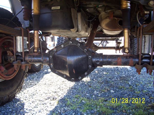

^ Might just be me, but is that pipe as a lift block in the rear!!??

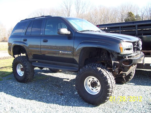

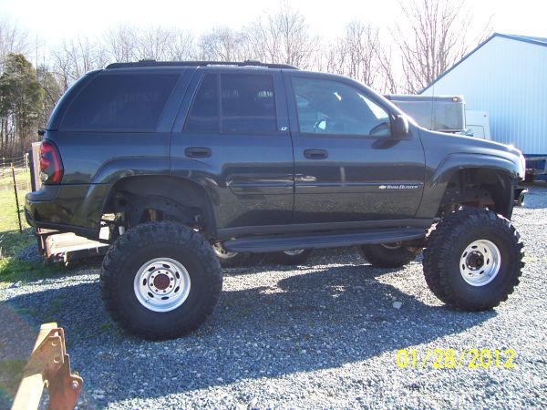

Looks very sloppy. But a good starting point! I could buy that and just transfer over my accessories!

I attached the pics from the Raleigh SAS just so we would have them for historical purposes.
by fishsticks » Thu Apr 26, 2012 2:47 pm
Both axles need to be moved or tires will self clearance the body badly when it flexes.
Oh, wait. Those flat leafs in the back are never going to flex upwards.
...and those lift blocks.
No front DS.... I'll bet there's either no steering or it's scary as hell.
I'm guessing there's quite a bit on that thing to torch off and start over on.
by navigator » Thu Apr 26, 2012 3:50 pm
looking from the rear I don't see any steering.
