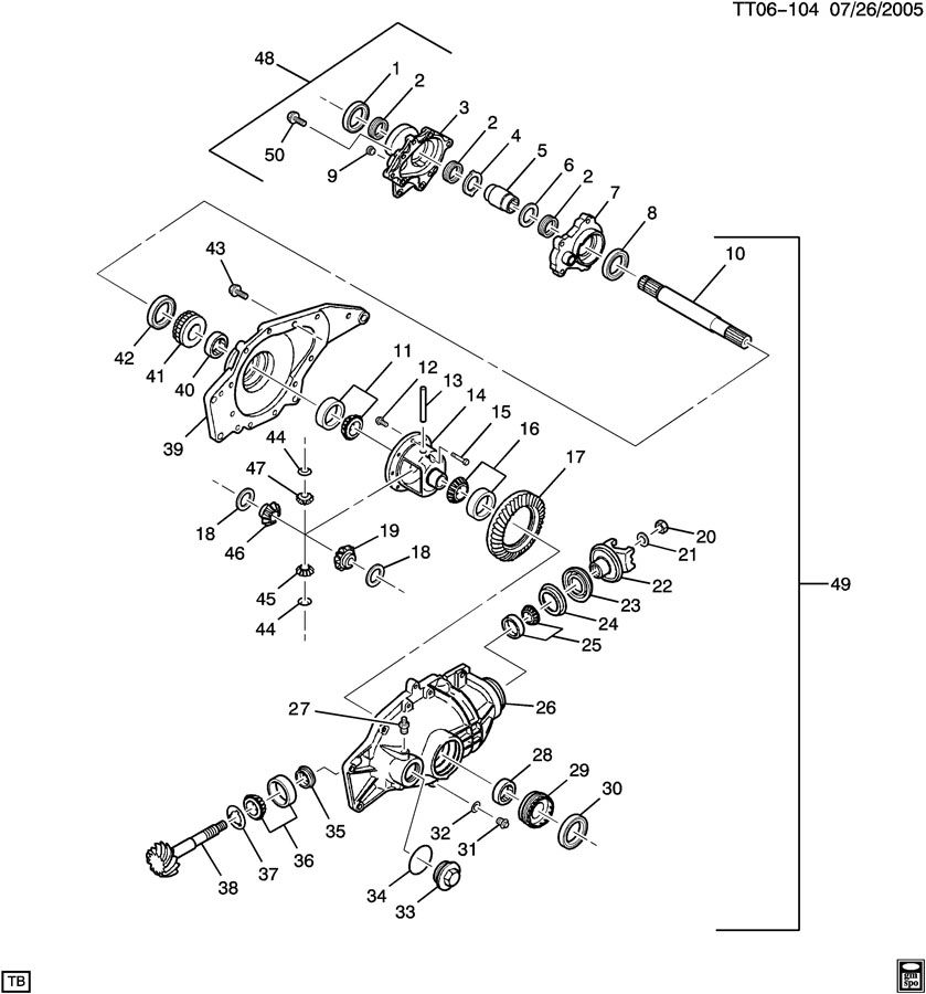

I need to change the ball bearing (pos 28) on the front left side axle and i need to know if the differential bearing adjuster (pos 29)can be removed and reused , or i need to order it new as well ? I'm asking because it's about $140 and i would really like to be able to reuse it ! Please advise ..

You'll need a new seal (30) but the adjuster (29) is reusable.

by Skindiggers » Thu Feb 09, 2012 2:38 pm
Thank God...
How can i take it out ? Do i need a special tool ?

by fishsticks » Thu Feb 09, 2012 5:41 pm
There is a special tool....but you should be able to knock it loose with careful application of a hammer and flat screwdriver.
It just unscrews after that.

by Skindiggers » Fri Feb 10, 2012 8:45 am
Wow nice , thanks . so i can take the bearing out without taking the adj. out !
Anyway my problem is with the other side , were the disconnect is , there i have a big play in the axle , on the side of the diff , the play is small ,but i was thinking to do it as well , now after i saw your post and the video , i might just leave it like this , until it will become a bigger play !
