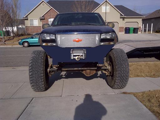

by chevycrew » Wed Jan 04, 2012 5:07 pm
Headlight/Grille repairs and mods are complete...

by navigator » Wed Jan 04, 2012 6:20 pm
hey, have you thought about adding a plate/guard up front?
Kind of like this? Unsure about the color or coverage but you get what I mean.
by djthumper » Wed Jan 04, 2012 6:23 pm
The bow tie is crooked
by chevycrew » Wed Jan 04, 2012 6:25 pm
Crooked? In what way?

by chevycrew » Wed Jan 04, 2012 6:43 pm
Actually I went out and moved it just now between posts...
The stock bowtie fits through the holes in the mesh, but I cant perfectly center it. If you look close in the pic (count the holes) it is off about 1 hole to the passenger side. I moved it up one hole, and to the drivers side a hole. Its still off about 1/4" from being perfect, but I dont want to commit and chop bigger holes in the grille.
