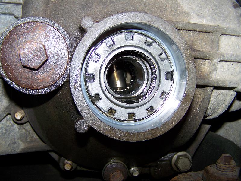

by Trail X » Tue Apr 09, 2013 12:42 pm
Here's the adjuster.
by navigator » Tue Apr 09, 2013 12:54 pm
that is good to know. I almost pulled mine out to replace the bearing when I replaced my front diff seal.
I went ahead and bought that bearing when I bought the seal just in case.
by Trail X » Tue Apr 09, 2013 12:59 pm
The bearing basically seats into the adjuster. The adjuster is then threaded into the housing. So any rotation in the adjuster will change your carrier bearing preload.
by Conner299 » Tue Apr 09, 2013 1:11 pm
JamesDowning wrote:The bearing basically seats into the adjuster. The adjuster is then threaded into the housing. So any rotation in the adjuster will change your carrier bearing preload.
So theroretically, if you marked one of the "cogs" on the adjuster with its location, relative to the seal housing, and counted the amount of turns until it came, you could replace the bearing and reinstall with no possible repercussion?

by bgwolfpack » Tue Apr 09, 2013 1:25 pm
Backlash 0.13-0.18mm
Pinion bearing preload 1.7-3.4N-m
Pinion and Diff Case bearing preload 3.4-6.2N-m
New bearings #s only
Good luck

by Cable810 » Tue Apr 09, 2013 3:57 pm
So the adjuster/tensionder is located behind the Seal. Cause I don't see it. Cause if that be the case there should be no way I could bump it out of spec. Just makin sure.
by navigator » Tue Apr 09, 2013 4:25 pm
correct, that is what Donny was saying. Don't mess with the outer seals and you should be fine.
by Trail X » Tue Apr 09, 2013 5:14 pm
Conner299 wrote:...you could replace the bearing and reinstall with no possible repercussion?
If you replace the bearings, you will have to readjust. Bearings can have minor variations between them. Being that they set into a conical race, the variations are multiplied - this is the way the differential accounts for those differences, so they can be adjusted to work with the tolerances of the bearings, races, and carrier.
