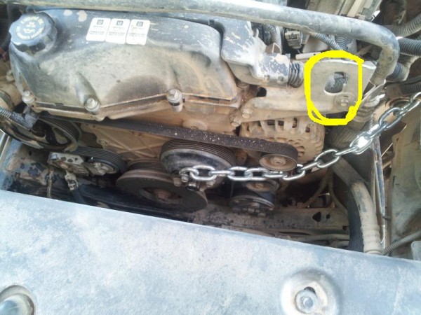

Shdwdrgn wrote:ok progress is disappointingly slow... however I have the disconnect out on the bench and almost disassembled. HOW do I get the outside seal out? I punched the bearing from inside and have it flopping against the seal, but I can't get the seal to budge.
Also, I read I'm supposed to remove the center axle from the disconnect side of the oil pan, but it doesn't seem to want to move, and I have no idea how I would grab ahold of it except with my fingertips...
Shdwdrgn wrote:I'm trying to follow Regulator's suggestion for pulling the diff up through the engine compartment... Everything is loose on the bottom end (finally got the half-shaft out, and the diff is unbolted and popped loose from the pan)... HOW do you pull out the fan? I see four bolts on the pulley, and four bolts holding the blade to the fan clutch... but I don't see how the fan actually comes out?
take out those 4 bolts and then get a chain and hook it to the fan somehow and UN screw that big nut and the whole fan and shroud come out together

I replace one of the 4 bolts with a longer one threaded through a chain. Then take the chain to the drivers side control arm and wrap it and bolt the chain to itself snug. Then it is just a matter of getting a big wrench to break the fan from the water pump. The fan and shroud will lift out in one piece.

In regards to the fan, usually if you put your wrench on that big nut, and give it a good smack to break if free, it will pretty much spin right off. And same thing when you put it back on, after its snug, give it a smack to lock it down.
My motor has a lifting point similar to this one built in. I know Dirty Bacon just runs the chain to here. I've done the same on my truck. If you dont have chain readily available, you can back out 2 bolts on the fan pulley and wedge a screw driver between them to hold the pulley. It works, but can be a PITA. The chain is definatly easier.

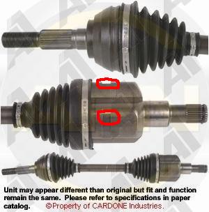

Oh, by the way... when I go to put the axles back together, what do you do to get those C-clips to snap back in again? I noticed there seems to be some sort of slider inside the CV boots... do you just use that with the weight of the axle as a ram to snap it back in place?

You can try and align the CV as straight as possible and hit the hub end with a hammer. I found it difficult to get that to work.
I have been successful with putting a large flat blade screw driver in this groove, and hitting the screw driver with a hammer.
Another tip would be to use a little grease on the c-clip to help it stay centered on the shaft.

All right, back to the grind... I think I'm going to abandon the engine route and try to get in through the steering rack today. Anything I should know about removing any of those frame brackets or the steering rack? Anything I need to do to keep the steering in alignment when I pull it apart, or will everything stay self-contained?
