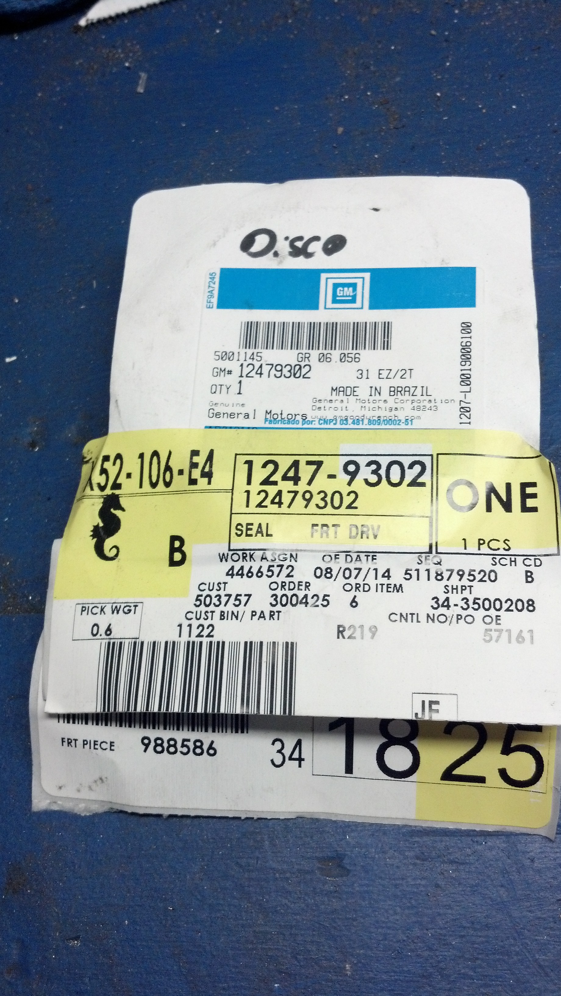

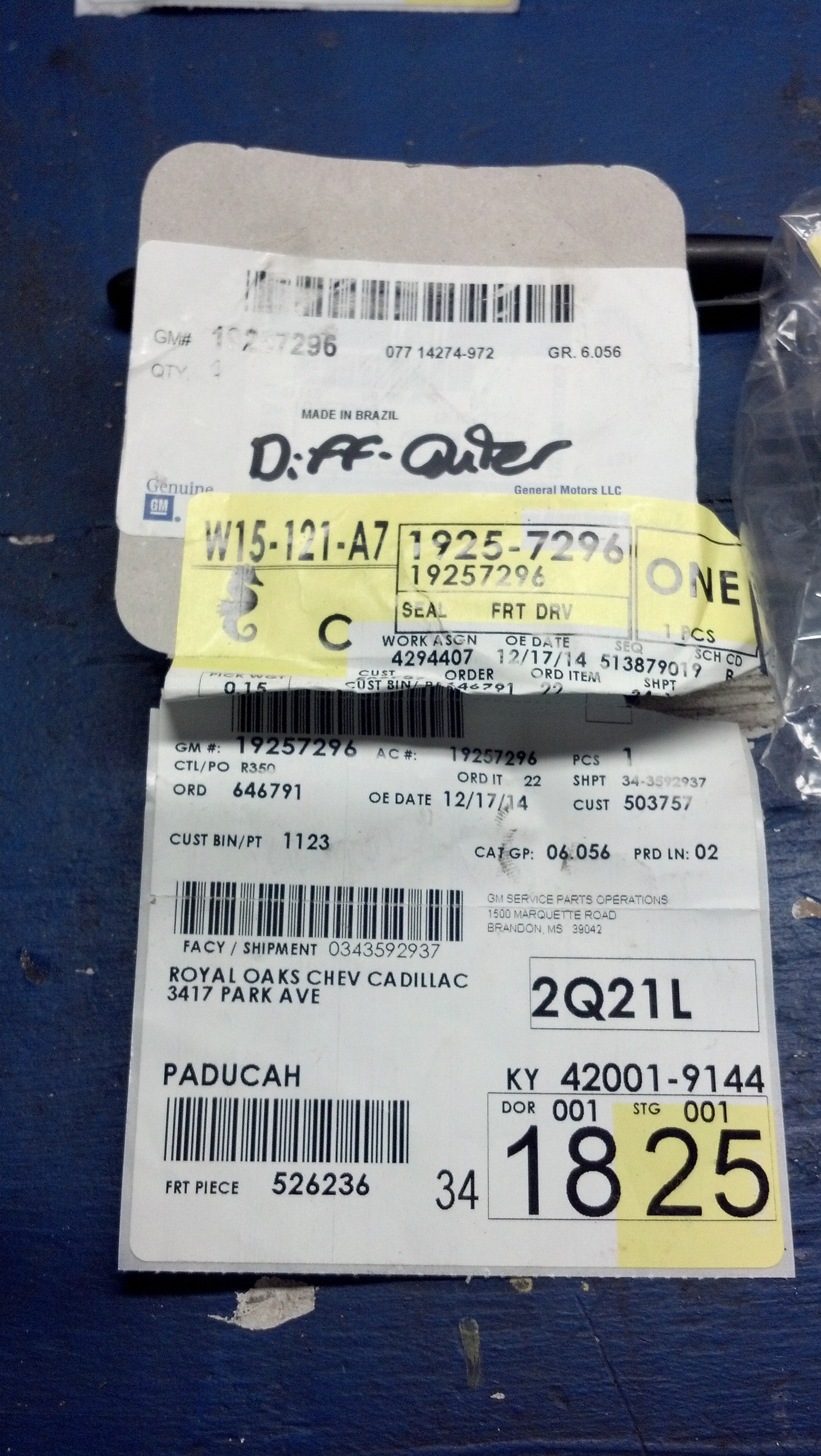

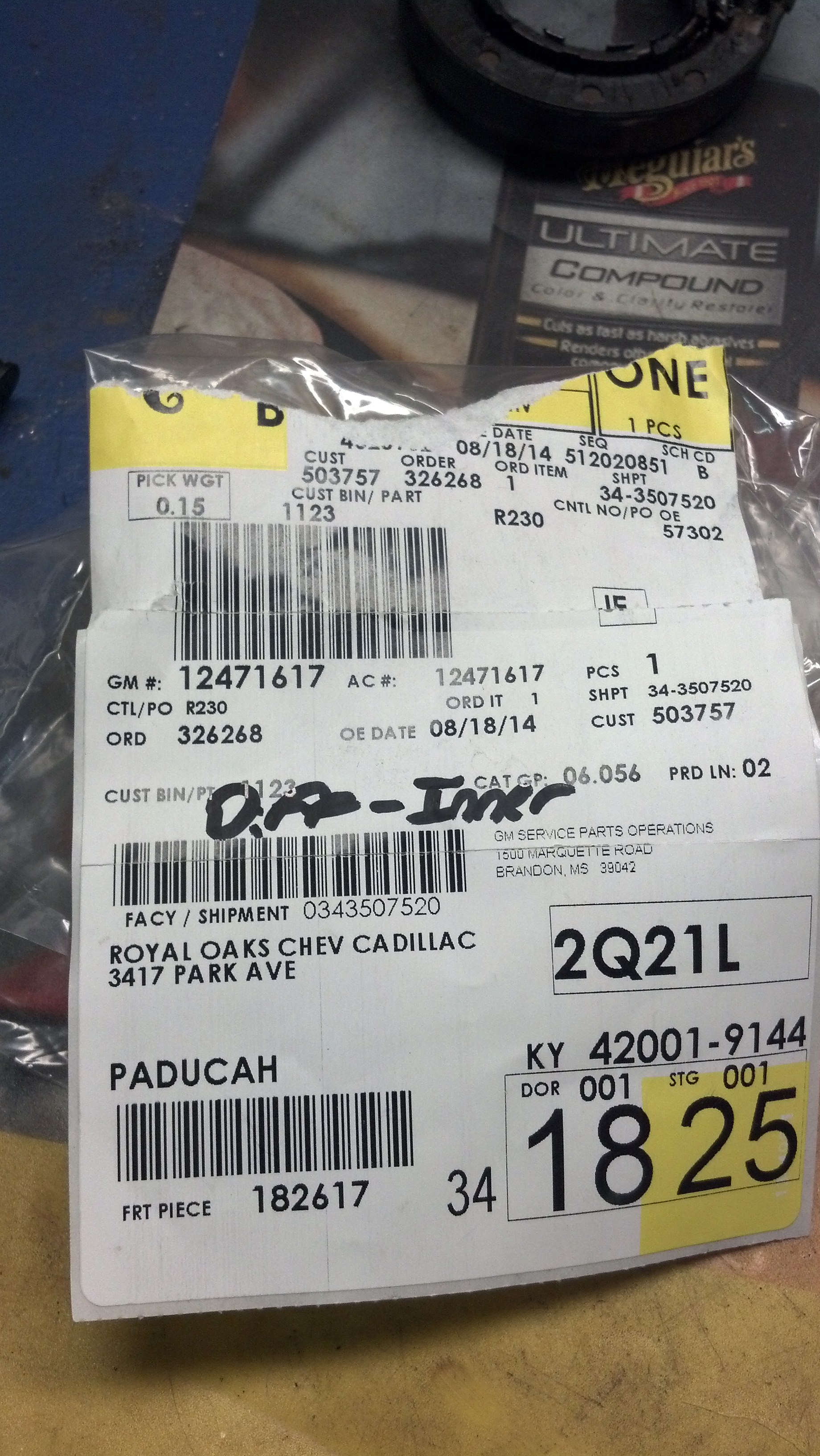

As a reminder, NOW is a good time to replace the seals on the diff and the disconnect, especially the outer ones. Check your bearings and tear down the disconnect to regrease it. Make sure you seal the disconnect motor well so water does not work it's way back in to the housing. Its been mentioned here, and elsewhere, for years. If you're going this far, you should already know this.
CURRENT (Early 2015) GM part numbers can be found in the pictures below. Pictures are both seals for the differential and the outer seal for the disconnect. Both differential seals will have metal tabs on the back that will fold in to place to hold the adjusters for the carrier in the diff. These are offset on purpose and will not match the adjustment rings in the diff housing. This allows you to seat the seals in any orientation and still allow it to grab the rings with 3 tabs. If you don't understand now, you will once you remove the seals. I do not have the part number for the inner disconnect seal, I ran out of time on the project, due to removal of the diff that had jammed in the oil pan, but my seal was in perfect shape and holds grease instead of oil. Most dealers will try to sell you the outer diff seal and the outer disconnect seal, so cross reference the parts correctly. These are identical seals to the OEM AAM ones that you'll be pulling out.
