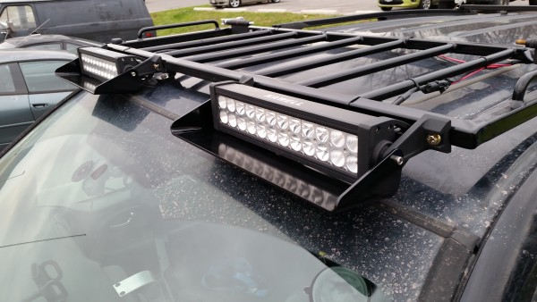

A good product idea to think about would be if you could produce a 50" curved visor for under the light to reduce windshield glare. Kind of like what James did but for one continuous bar.
