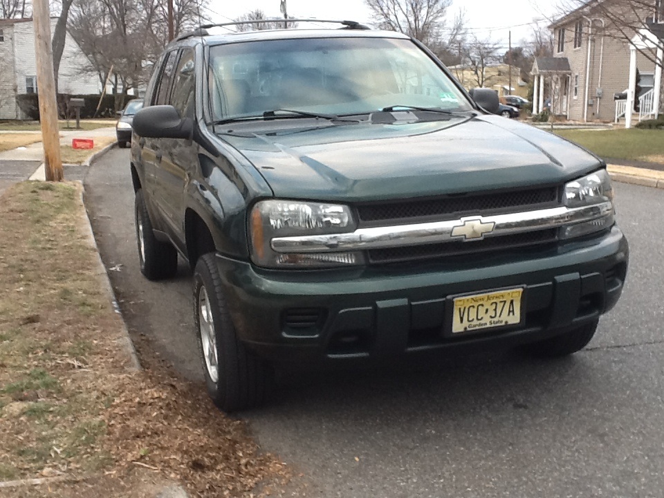

darring70 wrote:I dont wanna spend a lot of money on my tb because my wife will kill me lol, If any body have a 3.42 gears with 285/75 16 or 265/75 16 please give me some info, and pics, thanks
So probably I gona be able to go
