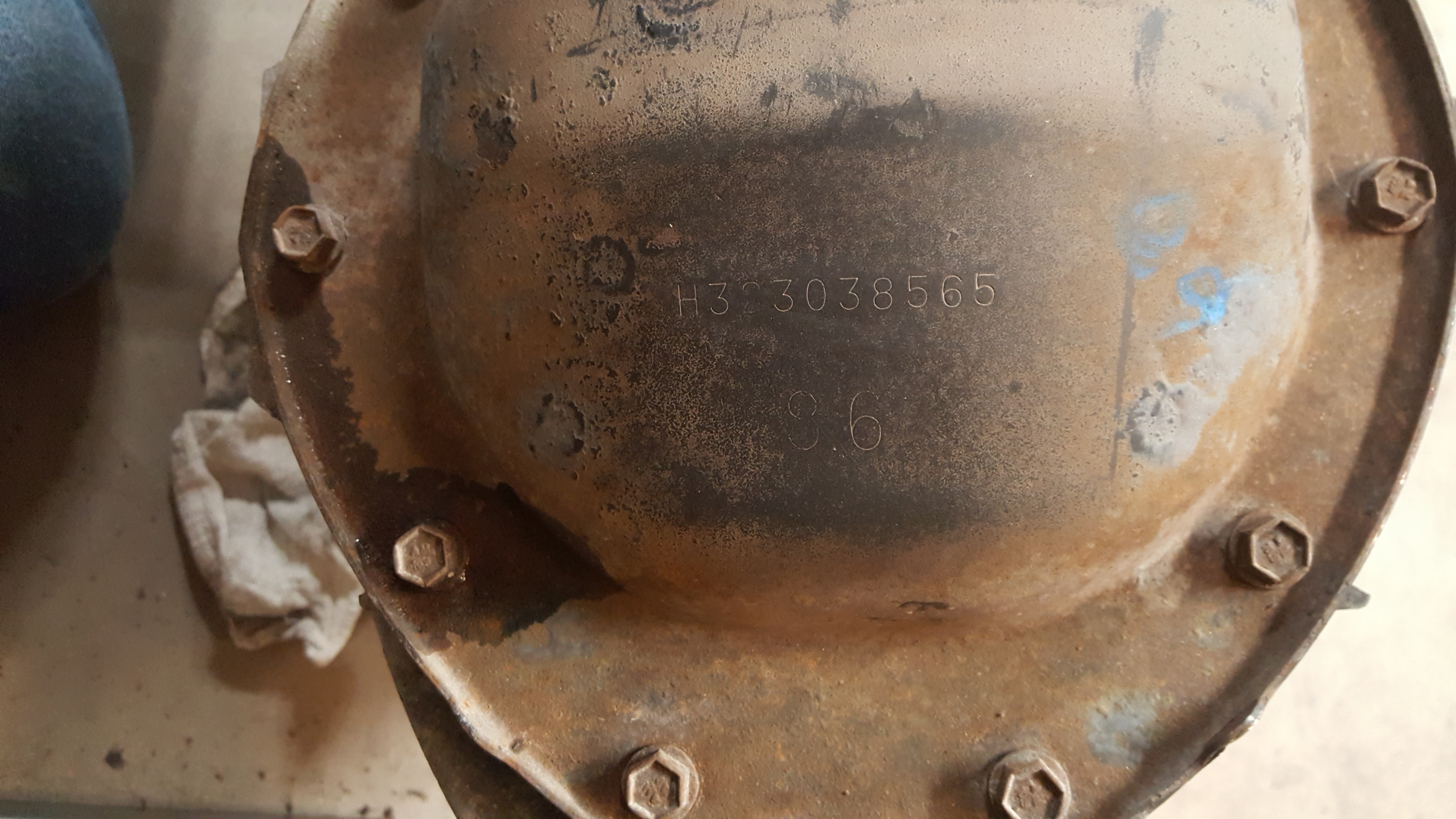

by AzEric » Tue Jan 15, 2019 12:02 am
Naturally, after posting this, I found the thread:
search.php?keywords=8.6+cover&fid%5B0%5D=72
In which there is an image of a stamp on the cover, which got me looking more closely at my new diff cover...

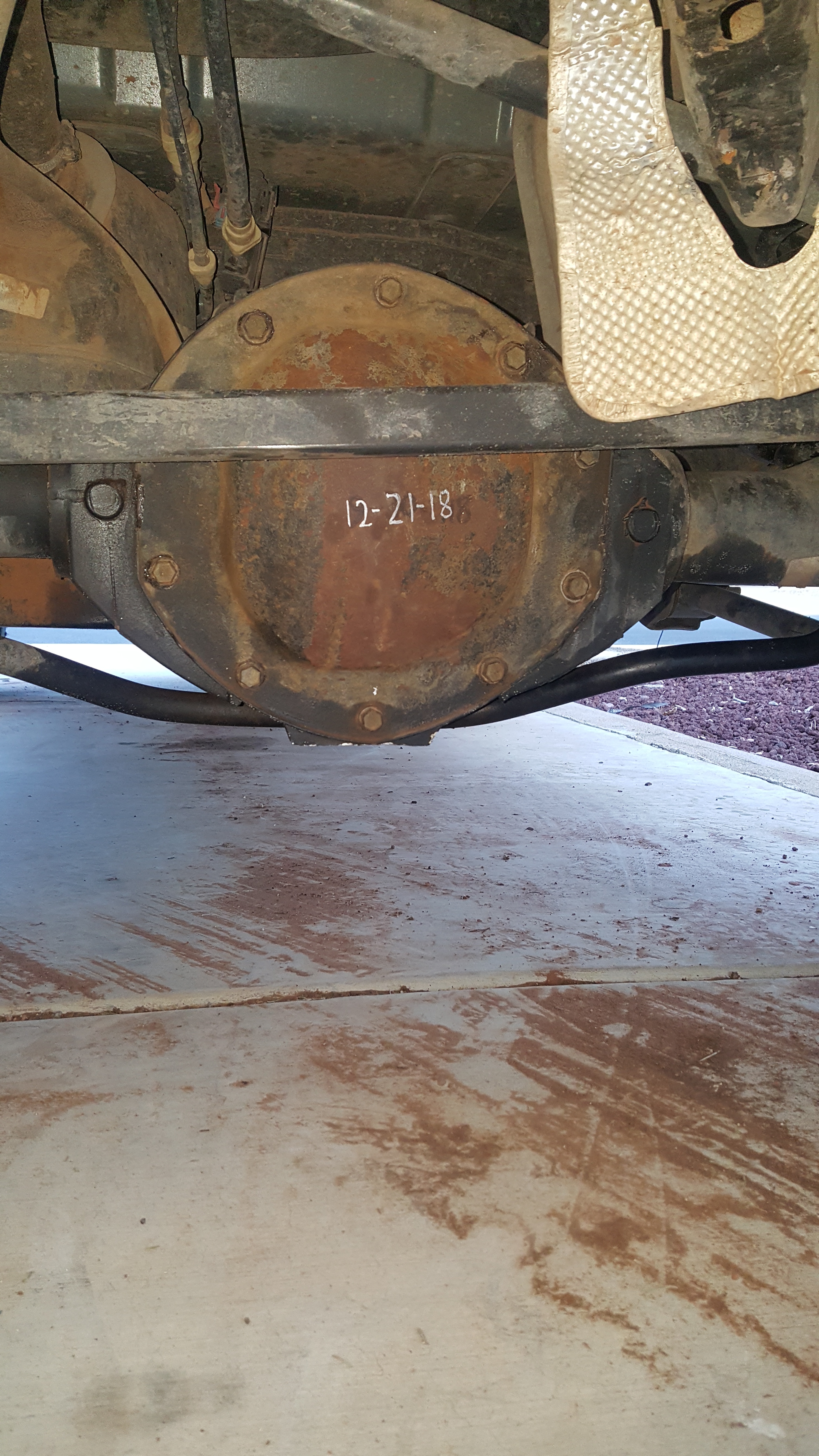

by AzEric » Tue Jan 15, 2019 12:15 am
8.0 and 8.6 do indeed have identical (in appearance) covers, have to scrub and remove rust/dirt to see the stamp in the cover to verify.
Cheers!
Old...
Vs. New!!!

by Wahugg » Tue Jan 15, 2019 5:15 pm
Eric,
It looks like you found the 8.6" stamp on the outside of the new cover, an easy give away that it is indeed an 8.6" diff. See my response in the other thread if you have more questions.

by AzEric » Tue Jan 15, 2019 11:48 pm
Yeah, I looked at the cover when I got the pallet, didn't see the stamp until I saw that other post and got out some 220grit and the air gun... :idea:
