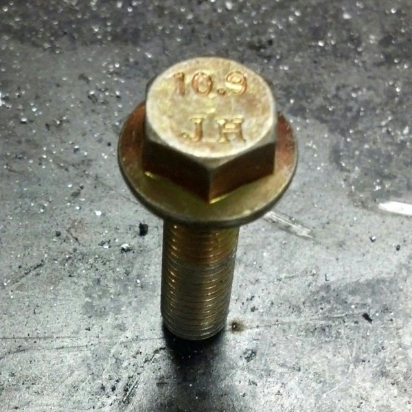

So I finally got around to looking at my exhaust leaking. I was hoping that it was just a cracked manifold like you normally see but it seems that my manifold is good. What I did find was the my rear mounting bolts on number 6 and 5 cylinders are messed up. I felt # 6 to be loose so i started to loosen it by hand and you can see how far I got with the picture. # 5 is completely missing the bolt head. So I went ahead and ordered a new manifold from rockauto and some O2 sensors since I will be down there anyways. I'm going to get the bolts from the dealership since I read on GMT that the doorman ones come as grade 5 not 8. Looks like I will be having a fun weekend in the near future

by Trail X » Sun Feb 23, 2014 11:52 am
I used the dorman ones, I actually applied anti seize to mine. As I recall, the dorman ones did have the 10.9 stamp on them, but don't hold that as gospel. (You won't find metric grade 8 bolts.)

by Moots1288 » Sun Feb 23, 2014 6:09 pm
The dorman ones are probably 8.8 cause they're metric and 10.9 is equivalent to grade 8 just without the yellow zinc coating.
by Trail X » Sun Feb 23, 2014 8:42 pm
Looks 10.9 to me. The dorman package came with 1 extra that's been still floating around my shop.
by Moots1288 » Sun Feb 23, 2014 9:01 pm
JamesDowning wrote:Looks 10.9 to me. The dorman package came with 1 extra that's been still floating around my shop.
well I said probably, going by what to op said. I have never bought a set.
