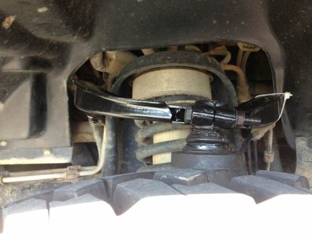

Replaced and flipped my UCA's!

by Trail X » Fri May 03, 2013 4:50 pm
Josh, do you have your old UCAs? I'd like to have them if so.

by SaltWaterDrinker » Sat May 04, 2013 7:30 am
JamesDowning wrote:Josh, do you have your old UCAs? I'd like to have them if so.
The bushings are practically nonexistent. I left them behind; I can go back and get them if you want!!

by dvanbramer88 » Sat May 04, 2013 8:53 am
SaltWaterDrinker wrote:
I paid a shop way too much money to Replace and flip my UCA's!
:finger:

Ah, I was wondering why he said he left them behind... it didn't compute till now.
How bad is bad when you're talking about the bushings?
by v7guy » Sun May 05, 2013 11:55 am
I was texting him about it yesterday, apparently you'd need to replace the bushings to get something useful. Or maybe just chuck some plastic rod in a lathe and turn it down to the bushing size.
