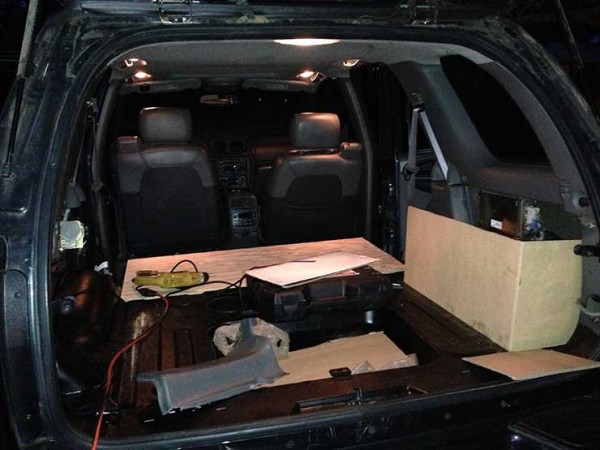

Decided to get moving on my rear storage and platform idea. Gotta get it done by TECORE. Pretty rudimentary stuff. Wish I had more carpentry skills.
by Trail X » Wed Apr 03, 2013 8:38 pm
Looks like its time for a dedicated thread for that one Mike. - well, maybe after TECORE, eh?
by mikekey » Wed Apr 03, 2013 8:51 pm
If it works and doesn't turn into a total diaster.
