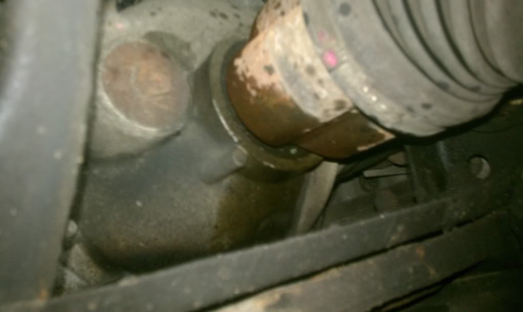

by bdp1978 » Thu Jan 12, 2012 10:04 am
SONOVA!!! :facepalm:
Less than 2 weeks after having my entire passenger side ripped apart to repack the disconnect and replace the hub I found this last night.
Looks like Ill be tearing apart the diff side tonight. My truck is like the Dolly Parton of cars, needs constant surgery to stay on the road.
