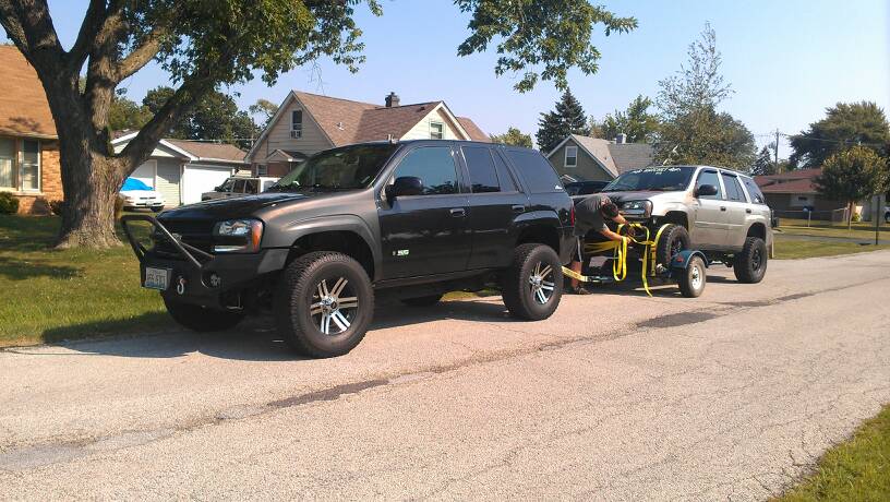

I got 10.38 mpg. Mostly highway and mostly around 68 mph.

My 10.38 was pulling Hatchets truck on a tow dolly. That's why I posted the pic. I seem to be getting in the low 13's pretty regular. I'm pretty happy with that!

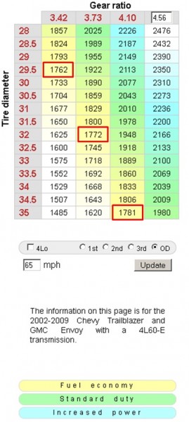

I know fuel mileage is really dictated by driving style, vehicle/driving condition. That aside I have been studying the gear ratio calculator chart to see if there could be are any sweet spots for MPG in each gear ratio/tires size. Comparing the stock rpm's and were the rpm's are very close to stock in each gear ratio I come up with the below sweet spots points. On 3.42 gears and 29.5" tires sizes you can easily get around 20 -22 MPG on the highway. Now I know Kyle has stated many time he get's around the same MPG's running 35". His comments intrigued me to look into this and the only explanation I can come up with is this theory or he is just BS us. Just kidding .... really. :finger: I could be all wet on this theory but i think it is worth noting.

I ran a bunch of numbers way back when and it worked out that with my tire size and gearing andsuch...My current setup equates to about a stock 3.55 ratio.
I think you are on to part of it. My lack of speeding much is another big thing. I know somewhere someone showed how much more drag you got going from say 70 to 85 versus going from say 55 to 70.

I'd imagine increasing the distance from the ground as you go up in lift is a contributing factor as well. A lot of variables at play. Changing gears isn't going to magically make you get stock MPG's of 18mpg. These cars don't get amazing stock fuel anyhow.
