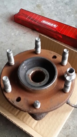

by CNCwell » Mon Feb 03, 2014 11:34 am
So I replaced the wheel hub this weekend. The problem is that I am not sure if the hub was the problem. When I pulled the tire the spacer was a bit loose and 5 of the 6 lugs were cross threaded. One was so bad that I had to saw one of the posts off. When I spun the hub after I removed it I didn't hear the normal rattling sound indicating that the bearing was gone. I'm not sure if this is a coincidence or not but I wanted to document this in case anyone else had a similar issue. I did check the other wheel spacers and they seemed fine.

by jonbo2002 » Mon Feb 03, 2014 12:11 pm
what did you do use an impact to install your spacers and wheels?

by The Roadie » Mon Feb 03, 2014 12:32 pm
Did you do it or a shop? What torque did you use on your torque wrench? (100-105 ft-lbs?) Had you taken your wheels off in the first 500-1000 miles to check and retorque your spacer lug nuts?

by Trail X » Wed Feb 05, 2014 5:42 pm
Cross threading lug nuts and having them spin all the way down is pretty hard to do especially with the stock installation lead-in on the tip of the stud, so I'm very surprised it actually was cross threaded. Are you sure they were cross threaded and not just seized? Did you use anti-seize upon reinstall?

by mikekey » Fri Feb 07, 2014 9:18 am
I didn't see the word "loctite" anywhere in this thread, but I'm pretty sure my directions from Mark recommended using blue loctite on the threads. Which is what I do.
