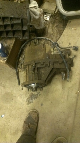

by tarsh » Sat Mar 22, 2014 10:58 am
Found the problem :facepalm:
Made lots of rucouse going down the road.
Problem presented itself :mechanic: local salvage here I come.running ATF. Supposedly ok for a transfercase. What's your thoughts
Take the path less traveled
tarsh
Posts: 483
Location: MI, Holly
Name: Nathan Schroeder
