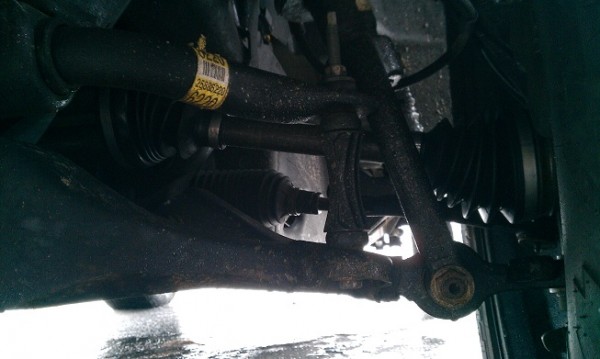

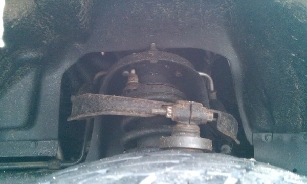

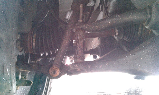

Justin, I reccommend that you get your TB back in your own hands, and you run through the 4WD diagnostic routine posted in our Tech Docs, here: http://www.offroadtb.com/articles/tech- ... wd-system/
That will greatly help us diagnose your system. It will also allow you to take pictures of your lift, so we can visually attempt to see if it is designed wrong. You can personally check if the lift is too high by lifting both front tires off the ground (by the frame), and spinning the wheels when in 2WD. Neither wheel should bind, and both should spin freely. While its in the air, check your upper ball joint, and ensure it's not the limiting element, if it is, it could snap. 4" is probably too high without the UCA flip.

just got my truck back from the dealer they said for me to take the lift off because it is causing the angle of the axle to be to much which will cause my front dif to go out agin. while driving it this morning i noticed it to be a little stuf in the front end i put it in 4wd because there its snow everywhere up here and had a little vibration in my front end i have never noticed this before also a little bit of binding when i turn while backing up but i thank thats just from turning a little to much i have pics i thank i am just gonna get a dif lift and roll with that

by Trail X » Thu Jan 12, 2012 5:08 pm
I have the equivalent to about 3.5" or 4" up front, and I don't have any binding issues.
What is the stiffness from? Do you mean steering-wise?
Your axles don't appear to be overly stressed.
What lift do you have? How is it designed? It may be allowing your suspension to unload too far, into dangerous territory.

by Trail X » Thu Jan 12, 2012 5:20 pm
The ready lift design (outside the strut) as a 3" lift, could be dangerous for your parts. Can you get a height measurement of the spacer itself?
However 'ready lift' markets their units as 2", and I believe some people have tried them out without much issue.
You can easily tell if you have too much lift by lifting either tire off the ground by the frame, and trying to spin it by hand (in 2WD).
