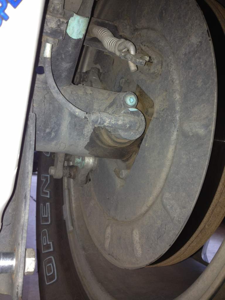

by 06MidnightBlue » Mon Jul 30, 2012 11:00 pm
Could this be it? Noticed it coming from the RR wheel sensor.

by Trail X » Tue Jul 31, 2012 12:40 pm
Are you referring to the slight leak? I highly doubt that a vibration felt in your steering wheel comes from a leaky rear wheel speed sensor.
by 06MidnightBlue » Tue Jul 31, 2012 1:35 pm
I didn't know if it was somehow affecting the ABS system in anyway
