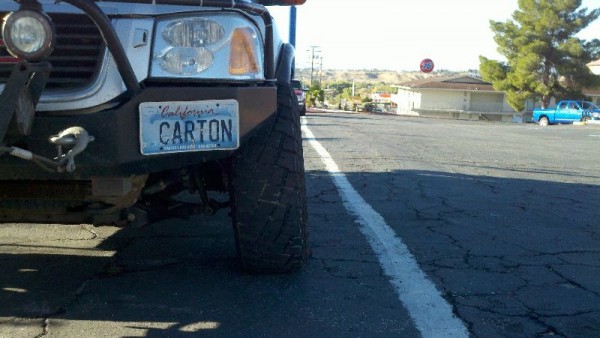

More pics as I take it apart, but I just had to catch a flatbed ride (free from AAA Premier) the last 125 miles or so back from SEMA. Wheel bearing had been noisy, and it got worse along the way to Vegas, but my experience is they just continue to make noise, and don't fall apart. By the time I made Victorville last night, it was wobbly. Snow and cold wind convinced me to not change it then, with the Timken spare I carry, but to spend the night, see what's up this morning, and then decide to use up my one 200-mile tow of the year.
It was not only wobbling, but the brakes were failing, and I could see in the light that it was tilting!

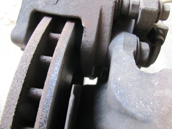

How the wheel moved
Bearing failed internally - will send it back to the vendor for analysis, whether or not they give me a credit. It has a one-year warranty, but let's see if they weasel out of it.

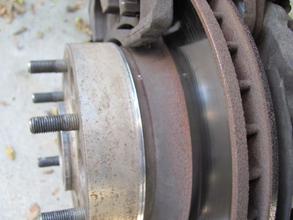

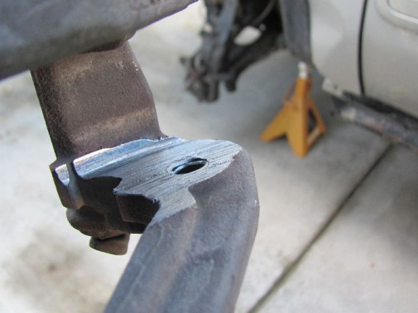

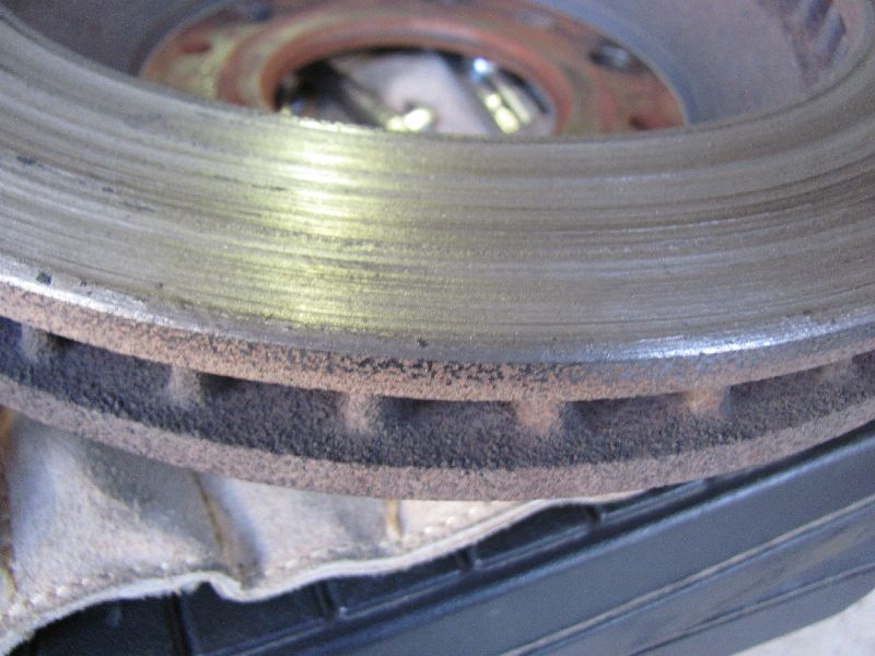

Wheel was kept from falling off the vehicle by the rotor scraping against the inside of the brake caliper - it took about 1/4" of metal off one inside edge. Very similar to the way my broken rear axle was retained by the rear caliper when the c-clip failed in the Montrose, CO incident. Aluminum transferred from the caliper to the rotor and then to the brake pad, so even if I had changed the hub on the trail, it still wouldn't have braked well.
Spacer pushed up into caliper
First hint at where the damage was:
Rotor:
Floating part of caliper:
