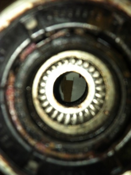

I'd still like to see the pictures you promised us. Very strange the piece of the puzzle that actually got tweaked.
by Mooseknuckle » Thu Apr 12, 2012 10:23 pm
Here ya go. Best picture I could get I'm a little drunk. New disconnect is in and 4 wheel drive hi and low is working very well. I'm still out 500.00 that was my trip money. So I'm still on standby. Dammit I could wring that dudes neck. Been looking forward to this trip for months

I honestly can't tell much from that image...

Lol no but for food and anything extra. It's hard to tell in that picture you can see it when ur looking at it.

According to your flow chart that was the issue now it's working again. We will see I'm going out again tomorrow.
