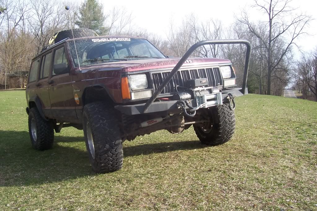

Am I missing something? Small stingers can be light mounting hoops, in which case they would be better called small light mounting hoops. Large, functional stingers are (as I understand the idea) to change the nature of an endover crash, and give the vehicle some side force to turn it into a roll that's more survivable for the occupants. More functional on something like a prerunner pickup, with very light back ends that might otherwise flip forward.
This might work when it's reinforced and completed:
This sort of design is just added weight for no purpose, except as a stylish looking brush guard:
I don't see how this one could help in an endo, although it's the right geometry, just weak:

Fwiw... I don't consider my bumper currently as a stinger.
Bill you are basically correct. There are few "stinger" bumpers built correctly to accomplish the intended goal. I liked mine for spotting trees and turning in tight situations though. If the stinger was closer than 12the in from a tree I wouldn't make the turn. Came in really handy sometimes but was not functional for rollover protection. It was more functional than the stock plastic or impact bar though.

I understand the difference between the intended and actual use for a stinger. And since the little one Mike welded on would better fit a light array then arrest an end-over roll perhaps I should have used a better naming convection than "stinger". I had adopted this vernacular from conversations with Kyle and Mike when we were discussing it's addition to the bumper.
However, I will change the wording in my build thread and continue to evaluate and plan an appropriate use, form or function for my overdone lighting fixture.
