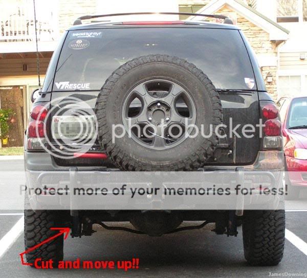

So I have not seen this brought up before. After looking at a pictuer of JD's rear ( :friday: ) I noticed a cheaper way (maybe) of getting our rear end up!
Why not just cut the rear shock mount and move it up 1'', 2'' or whatever height needed? Seems simple to me..... but I am no suspension expert.....
Picture cause I want to draw in paint...
Am I just crazy?

The shocks wont lift it, but might be an idea for not overextending the shocks

springs create lift, shocks control bounce. essentially what you are talking about is what we do. The spacers we use in the rear are like moving the mounting point up. thus creating lift.
Although there are some of us looking in to raising the sway bar and the shock mounts to increase the ground clearance.

Moving both shock mounts up a couple of inches was on my mod list to have Neil do soon as I got back to work and my mod budget improved. They are out of place for rock crawling, and hang down and are pretty vulnerable. But the articulation is OK, and the shocks don't contribute to lift; I was just going to do it to get the lower shock mount out of harms way. And more rock protection for the rear control arm mounts. He did the fronts with this little plate while fabbing the fuel tank armor.

Yeah, as everyone else said already. Moving the shocks up will not lift the truck. Springs control ride height. A lowering kit is shorter springs. A lift kit, in our case, is spring spacers to make the springs "taller."

There is benefit to moving the lower shock mounts up. It's basically the same effect as getting longer shocks. It allows more down-articulation of the tire, which is actually very handy.
Zero, you won't tear the shock apart by it being too short. That's actually a normal function of a shock... the shock acts as the down-stop of the axle. You can, however, mess up a shock by letting the shock bottom-out before the bump-stop (if the shock is too long) - a ton more force involved there.

Thanx JD thats what I meant, I had it backwards. I stand corrected.

The main ones are, I think, the e-brake cables (don't want to break, but not that difficult to lengthen), the rear brake hoses (REALLY don't want to break, not so easy to lengthen), and the ABS sensor wires if so equipped (ridiculously easy to lengthen). Just FYI.
Also, remember that you don't want so much articulation that the springs come off their mounts... That would be very bad once the axle tries to compress again :slap:

True, but thats why i am gona go the same way as AlekG and get limiting straps as well as a spring retainer kit. Just for peace of mind.
