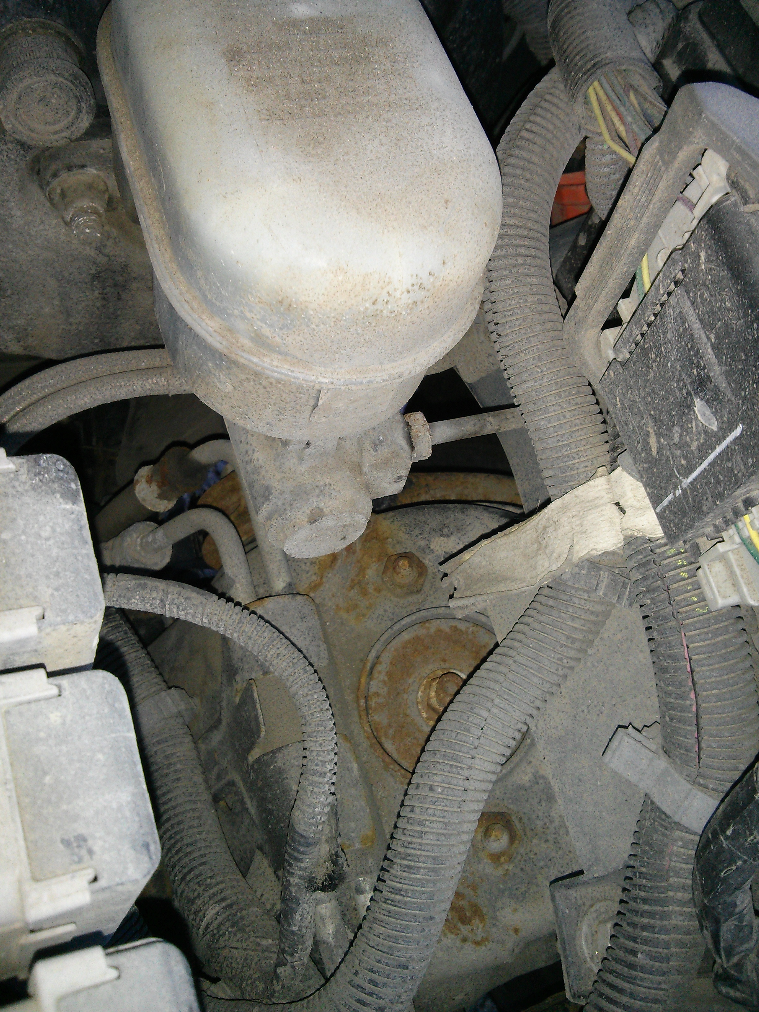

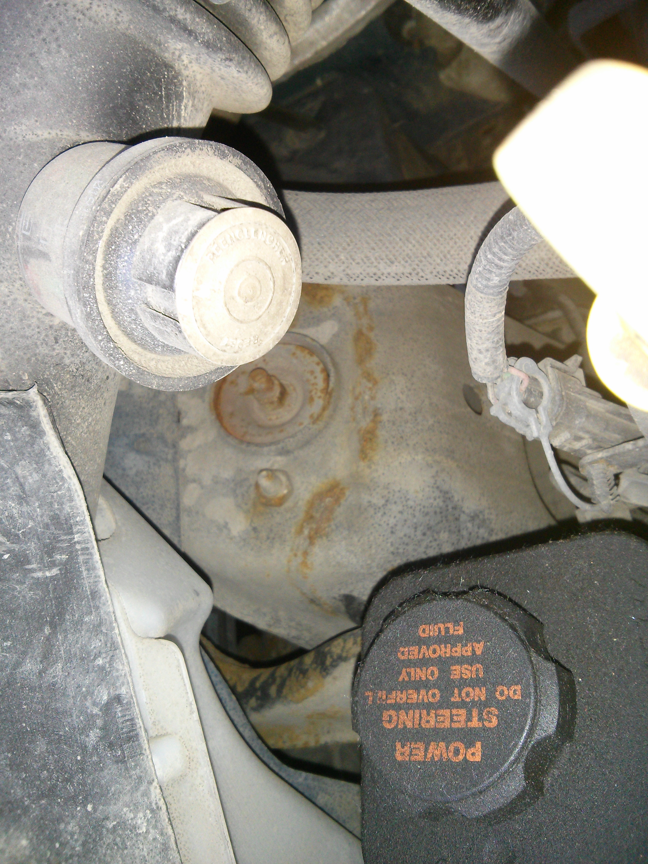

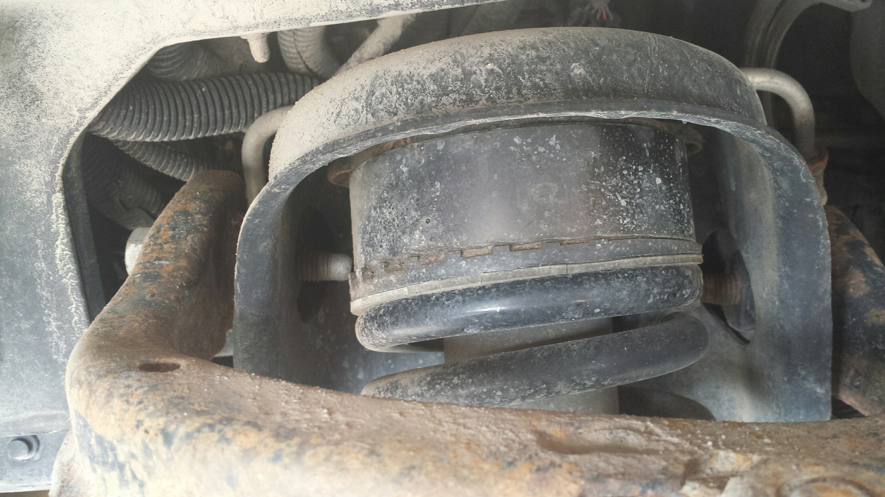

Would be great to have a opinion as to what is needed. I attached photos and you will notice the mount on one is degraded which is driver side though the passenger side seems to have more sag being that there is about a half inch less clearance between the passenger side tire and well over the driver side. I am wondering can I reuse my spacers for a new build and what else should I keep/replace. Also is it the 4600 series bilstein tthat everyones going with?

Looks like you just need a new strut mate kit or whatever.... Lift should be fine, but you will not know if you don't take it apart to see. Also what kind of lift are you running?

Yea man like I said I'm not there and it's not apart. Kinda looked like the rubber between upper strut mount and spring flattened out. Springs might help. Can't tell without seeing it more clearly brother.
Edit* oh I see, your spring flattened out a bit. Yea some moogs are probably your only option man, I've tried to buy sets from guys on here to no avail. Something always seems to happen. One guy flat out ignored me.

Manged to price out some parts via amazon. The mount itself looks like it is lower on one side, is there a certain way it should be turned when installed?

by markmc » Thu May 12, 2016 9:14 pm
Please post a link to the lift you have..
Those spacers look pretty thick and not the style i have seen BDS use..

by markmc » Fri May 13, 2016 6:46 am
How thick are the spacers? 1.5"?
And it appears they are retaining the factory upper mounts..
maybe post a pic of upper mounts from under the hood..
i have a hunch those spacers are home made and to thick..wich could be most of your issue..

by markmc » Sat May 14, 2016 5:06 am
Those are factory style upper mounts so i dont believe the front lift is BDS.
It is more like my 2.5" lift with what appears to be a thicker in assembly spacer..
i would suggest just replacing the upper mounts with new ones and call it good..
How thick is the spacer?

by AlbertaMatt » Sat May 14, 2016 3:36 pm
markmc wrote:Those are factory style upper mounts so i dont believe the front lift is BDS.
Yes. i am The Liftmeister guy
Spacer itself from what i can measure is 1.5 inch
