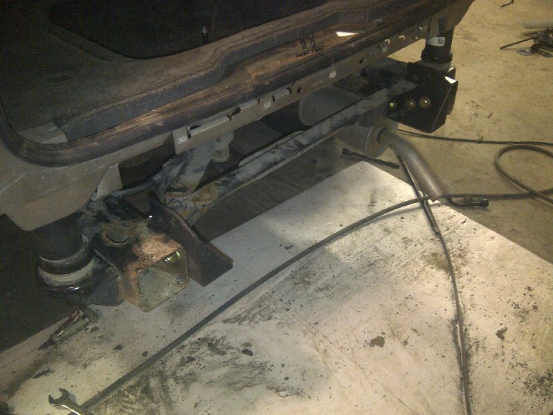

marks pics aren't great and it seems my brackets are differnt then the ones pictured. anyone with pics or help? its all taken apart now

post some pics of where you're at and I'll try to give you whatever guidance I can.
do your brackets look like the ones on the left?
there should of been a sheet of modified instructions with your kit for the new brackets. they are different than the instructions on the website.
it was remove rear bumper, cut off each arm on the bumper some amount (you will cut off one of the stock welded on nuts on each arm) Then you just notch the frame rails so the brackets and bumper arms will fit 3" higher

Yeah bro, those are the brackets. I didn't see any extra instructions but that doesn't mean they weren't there tho.

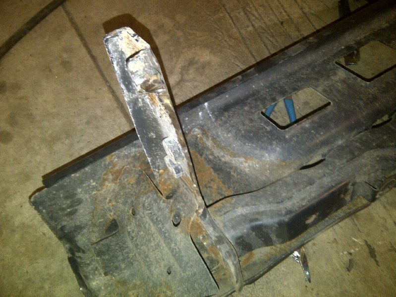

I didn't see your reply before the action though. We ended up trimming some metal from the bumper, basically on the part of the bumper with the captured nuts. We cut length wise under the three captured nuts and didn't cut the frame at all.
The bumper bolts to the bracket and sits on top of the frame. I think I'm gonna make up a bracket to run from the spot on the frame where the 3rd stock mounting hole is, up above the top of the frame and bolt through it into the 3rd captured nut. Maybe even weld along the seam between the bumper "tab" and the frame on each side, I haven't decided yet.

Since you didn't cut the frame it should be a lot stronger than if you did. If the only thing you cut is shown in the pic I'd say your probably good to go. Might want to add the lip back in if your able.
Guys tow with the bracket. But when you think about the thin (now unboxed) metal of the frame rail supporting the bumper I'm sure you can understand why it's a horrible idea.
After you notch the frame it's kind of equivalent to welding a piece of 1/8" thick L channel to the frame then bolting a hitch on to that and towing with it.

Yeah Jason, the only cut was the one shown. Instead of cutting the bumper support down and notching the frame up to the spare tire cross member, we cut the bottom lip from the bumper support horizontally (as it sits when installed). Now the bumper supports sit ontop of the frame but run all the way back to their original position.
I think I'll have the bumper supports welded to the frame rail along the edge that we cut off. That way the bumper is permanently attached to the truck. If I ever get a custom bumper for the rear, I'll just have the current bumper chopped back off.
