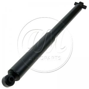

by SmokeyMcBlazer » Fri Jan 02, 2015 5:41 pm
i'll try to get a pic from on the truck if I can but I don't know if it'll show well but from this random picture
we cut off the two tabs from the stock shock that come away from the bottom eye (shown at the top of the picture). They are used to fill the gap in the shock bracket on the stock set-up. We cut them off and used them to fill the gap between the Skyjackers and the shock bracket instead of stacking washers.

by maricard » Fri Jan 02, 2015 6:08 pm
thank for this different way...
