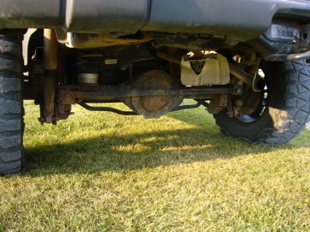

by Lauron » Sat Apr 12, 2014 10:22 am
Caleb,
a few things to look for:
1. with Mark's 2" spacer, the panhard bar should be horizontal. If it is angled, one side of your suspension is high or low. See my install below.
2. You installed the bracket loose and then tightened things up. I tried to install the frame cross member to the lower bracket hole as it was thought to be much stronger than the upper hole, but I found I would have to force the frame mounts together to install it there. So when you tightened the drilled hole bolt, did it distort/bend anything?
3. You had right rear fender damage. A variable I recognized when I installed the 3" body lift is possible misalignment with the frame and the suspension. To be out by a 1/4" would be easy. So could your body have shifted on the body mounts? Collapsed or loose mounts may contribute to the offset.
To get a total of 3/4" change is not due to the the angle/mount position of the pan hard bar only. :scratch:
Ron
Horizontal Panhard Bar.JPG (61.86 KiB) Viewed 20532 times
