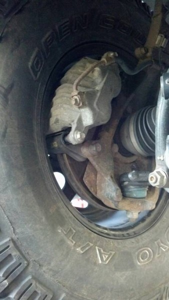

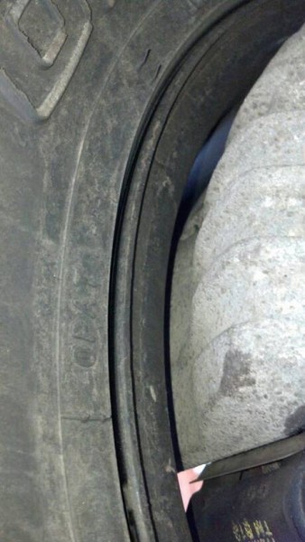

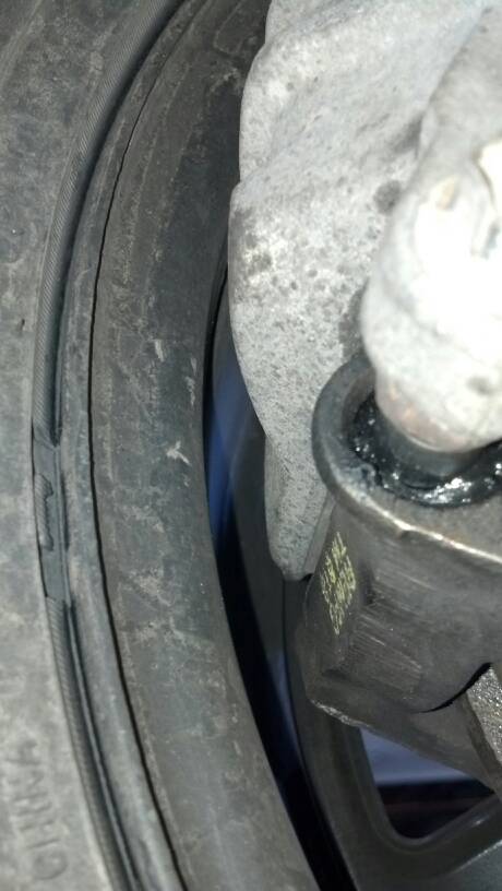

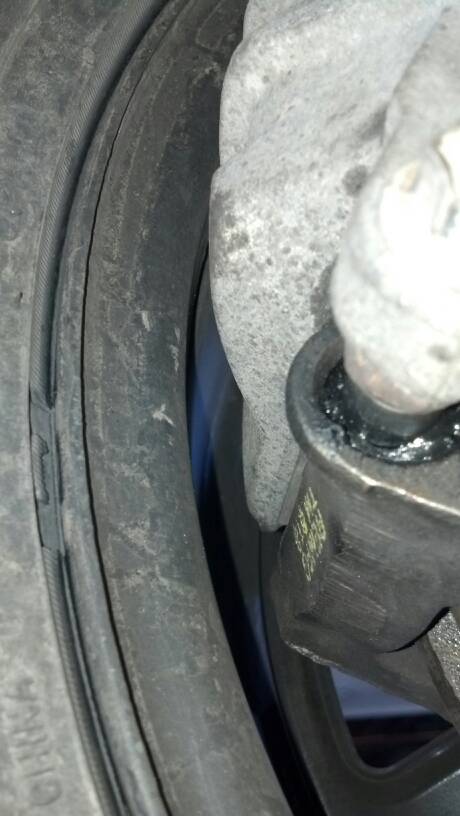

by JCrayton99 » Sat Oct 13, 2012 12:59 pm
I went ahead and did it. with MarkMCs spacers and wheels with 4" backspacing I was able to clear the EXT breaks. They are a smaller diameter on the outboard side and the rim ends right there. I have a touch over 1/4" clearance between everything. Such a great upgrade.
So 17" rim, or 16" with spacers and 4" or (less? More?) backspacing.

by JCrayton99 » Sat Oct 20, 2012 4:08 pm
Late on photos.

by JCrayton99 » Sun Nov 25, 2012 11:50 am
It would not work with stock wheels. If you want to stay with 16" rims, you need to have 4" of backspacing or less on top of the 1.5" adapters. Mine just barely fit, maybe 1/4" of gap at the most.
