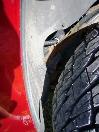

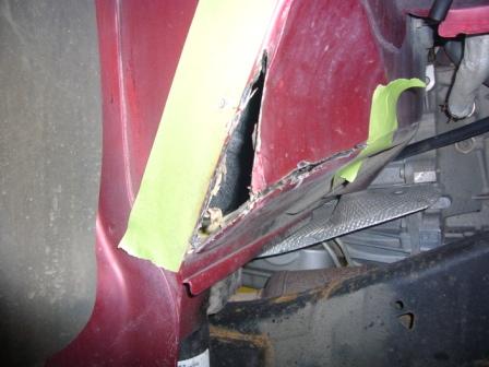

Even though I have a 3" suspension and 3" body lift there are a few rubbing locations to be addressed. Fenders were trimmed and the body behind the front wheel has the foot well projection that will touch, so it had to go.
Stock picture and cut out shows the amount of extension removed. My son used a small MIG welder to fill in the flattened cut out. Welding is a two man job. The sealant catches fire so, one person needs to closely watch the inside and put out the fires.
I am trying to retain the wheel well liners. Still a few rubbing places to work through both front and rear.

by fishsticks » Wed Sep 19, 2012 12:56 am
I've considered tubbing the front firewall there as well, but the rubbing is so minor it didn't seem worth it. I'm actually running LESS overall lift than you are right now and still don't have a problem. I rub on the frame more than anything.
Were you rubbing badly there?

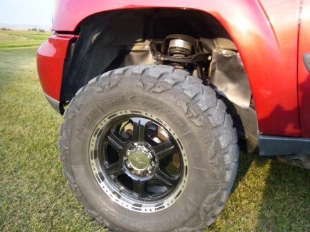

by Lauron » Wed Sep 19, 2012 8:33 am
Donny, before I got the WildPeak AT's, I mounted and tried these old Nitto 33's. I could see the 315" were going to touch.
Right now the liner, yes I still have them on :facepalm: , is rubbing just below this cutout section but I haven't fully flexed the suspension yet.
The liner is not snug to the fender wall. I plan to cut the bottom of the fender "T" section, fold it back and attach the liner to it. I did the same on the front so I think this will be the only rubbing point.

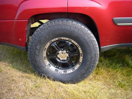

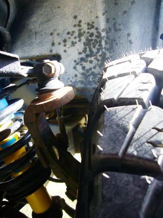

by Lauron » Wed Sep 19, 2012 8:56 pm
Wheel size and offset was a time consuming debate I had. Wide tires extending far out side the fender of course makes the rubbing problem worse. This concern caused me to go for the 3" body and suspension lift.
My wheels are 8" wide with 18 mm offset ( ~ 3.8" backspacing) Availability of wheels and tires caused me to end up with the greater clearance on the UCA than I could have gotten away with. I did want to go tighter because of tire stick out. As it turned out, the 315's are not too far out to hopefully not have the police to stop me. We are allowed 2" out side.

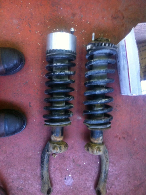

by Lauron » Fri Sep 21, 2012 12:26 am
I am using stock springs all around. The spacer gives you the lift without have to go to the stiffer springs for added height. I have 2" of up travel on the front before I run into the topping out of the shock. This initial install of the spacer on the old shocks was a challenge and as you can read many had problems with the spacers ballooning. My conclusion is you have to make sure the shock stud is fully made up. We used a shop wall mount compressor. The strut length picture shows the lifted strut is a little longer because the shock end is inside the spacer. The spring is much more compressed.

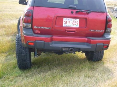

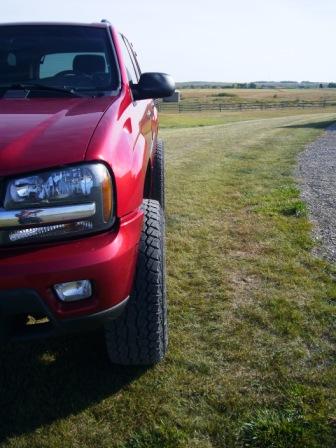

by Lauron » Fri Sep 21, 2012 12:06 pm
I appologize for this thread covering way too many topics.
It is correct, I was referring to both the front and rear tire clearance/rubbing problems.
This pic shows the rear. No rubbing currently but with flex it will touch on the inside, front edge. This is the drivers side rear.
So yes longer control arms would help. I am hoping to not have to go there. We will see.

by Lauron » Fri Sep 21, 2012 1:01 pm
Hey Donny, guess this is not what I wanted to hear but do appreciate your experience and effort to make it work. You are running the 35's, a little bigger than the 315's. Would this make enough of a difference?
Ron
