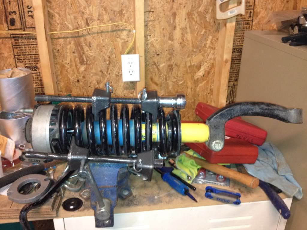

So I purchased a mark mc 2" lift, moog 81114's (86's i hope), and bilstein hd's.
I started about six and have gotten the front tore down but have been unsuccessful at compressing the new springs enough to install the lift. Looks like I'm going to get another set of compressors to get the the last of the spring compressed.
Truck 1...Me 0

by Mudwheelin » Tue May 15, 2012 10:58 pm
Just keep cranking on it man lol. Be careful though. I used normal ones. It was hard but got the job done.

you have to open the compressors a long way to get enough bite to compress them enough to put back together.
by boog2006 » Wed May 16, 2012 11:37 am
Yeah ended up using four compressors but got the strut assembly back together this morning.

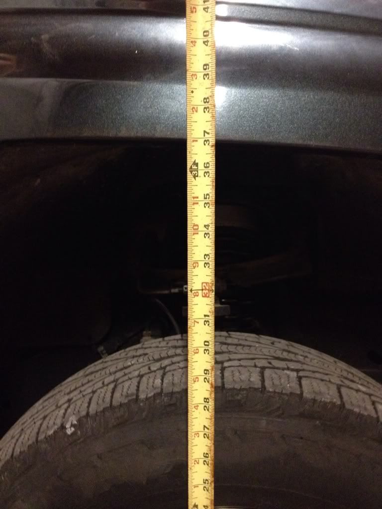

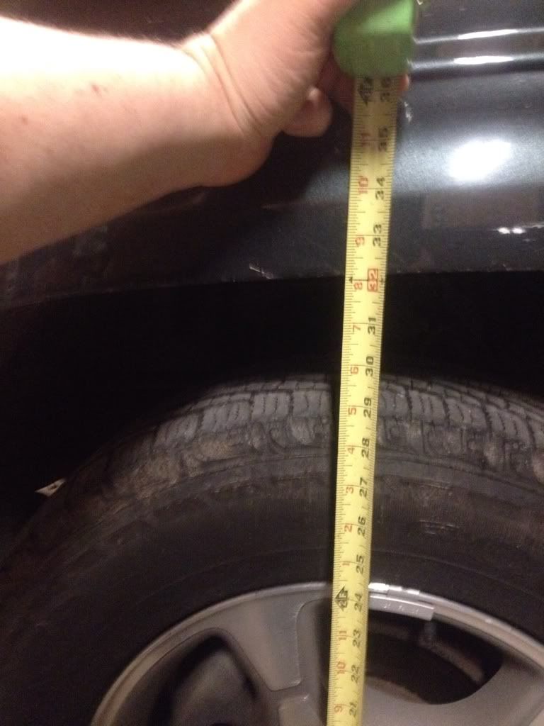

by boog2006 » Wed May 16, 2012 11:18 pm
Success!
This sucked...a lot
Success!
Before
And Lifted...5" total? I don't know how this happened...2" of markmc and moog 81114's...had 82's to start.
I'll post full pictures in the morning.
boog2006
Posts: 688

by boog2006 » Thu May 17, 2012 11:11 am
Before
After
After is only with front lift and z71s in the rear. I'll install rear blocks after I get me some new shocks ;)

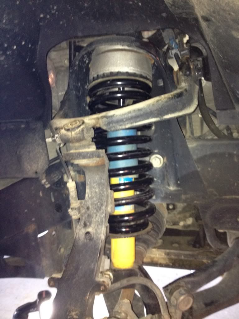

by boog2006 » Tue Jun 12, 2012 10:33 pm
Ok, so I've got about 900 miles on the lift and the truck is driving considerably better. :flex dirty:
Benefits -
1. Firmer ride quality. I can actually brake going into a curve and not feel like I'm gonna do an endo.
2. Slight rake front to rear of .5" using Z-71 and 2" spacer in the rear
Opportunities -
1. Moog 81114s seem to be performing similar to 89's. It is very easy for me to 'top out'. There are several 'dips' in the road on my way to work where i can work the suspension pretty good. These springs almost feel like the truck is being thrown up and out of the dip. I really like it. :woot:
2. I'm having an issue with the strut on the passenger side. I think I've got the nut torqued all the way down but there is about a half an inch of movement on that side since it settled in. I'd appreciate some assistance on this one. I really don't want to have to pull this thing off again. :mechanic:
Pics to follow this post.

by navigator » Tue Jun 12, 2012 10:42 pm
Boog, I'll try to check mine tomorrow when it isn't raining and when it is light out but in this pic something doesn't look right to me.

by snowmirage » Tue Jun 12, 2012 11:57 pm
I believe this is the same thing I have going on with both my front struts
