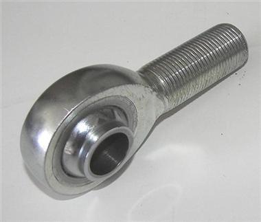

I'm thinking to change my rod ends and build some using Heim rod ends .
something like this
Has anyone did something like this before ? Is it safe ? Will i have enough angle of movement ?
Please advise...

The closest anyone has gotten to custom tie rod ends is the full-size pickup replacements.
The biggest challenge for you would be sourcing the tapered stud.

by navigator » Fri Jan 27, 2012 9:05 am
I think it would depend on how hard it would be to source a 7 degree reamer.
by chevycrew » Fri Jan 27, 2012 10:19 am
Should be simple, just drill out and use a bolt through knuckle and heim. I hate tie rod ends, although I'm solid axle, all my rigs run heims.

by Trail X » Fri Jan 27, 2012 10:36 am
Steve, I thought tapered stud was a particularly good idea when it comes to steering, because the forces of steering will move a regular bolt stud relative to the knuckle hole. Maybe thread the knuckle hole.
by Skindiggers » Fri Jan 27, 2012 10:57 am
chevycrew wrote:Should be simple, just drill out and use a bolt through knuckle and heim. I hate tie rod ends, although I'm solid axle, all my rigs run heims.
The idea is good .. but this means that i can never go back to original !

by chevycrew » Fri Jan 27, 2012 4:36 pm
Yeah drilling would be permanent, I have not had any issues with my bolts and holes moving, even up to 46" tires, hydro assist, etc. Tight bolts won't move.

by Skindiggers » Sat Jan 28, 2012 10:51 am
If i will not find another solution.. for sure i will drill it and put normal bolts !
