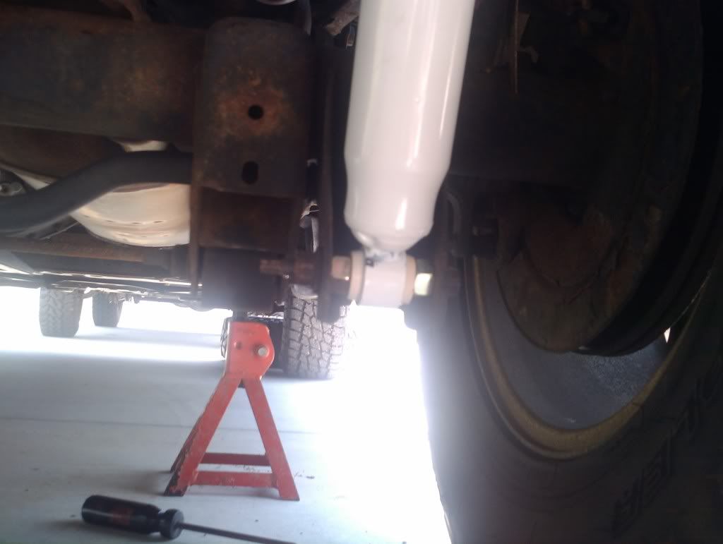

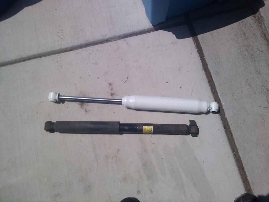

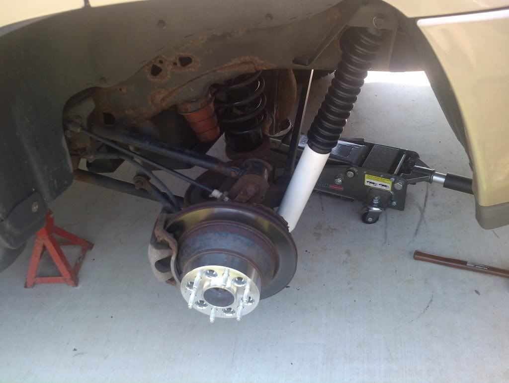

Well the new shocks are on and I have to say they made a HUGE difference!
(New Procomp shocks are better than blown stock ones not designed for a 2.5" lift? who would have thought right?)
Had to find some spacers to use on the lower shock mount, after a quick trip to the hardware store I just picked up some grade 8 nuts that were larger than the bolt but close to the right width leaving just a bit of play side to side on that lower mount.
All and all I am very happy.

O ya its 100 times better I am pretty sure the stock shocks were completely maxed out and had almost NO droop left in them, so they were probably bottoming out on every pot hole.
From what I have read they are indeed very similar to the BDS shocks.
