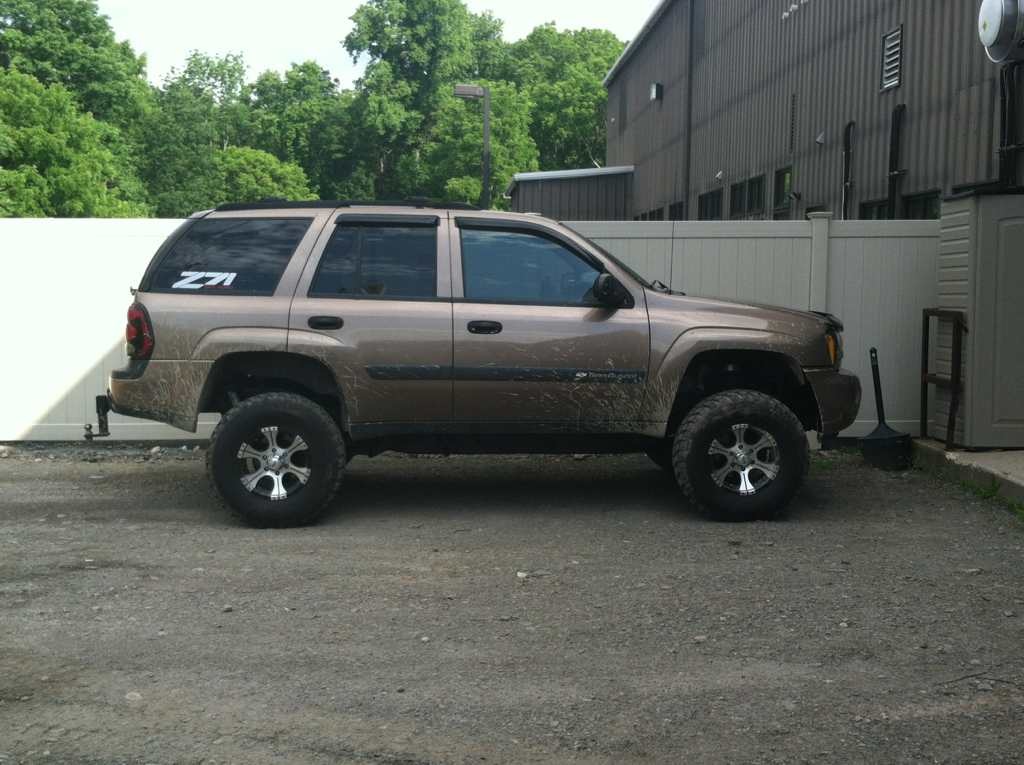

by Bcchevy » Wed Jun 26, 2013 8:51 am
How it sits now

by ErikSS » Wed Jun 26, 2013 9:09 am
Lookin Good!
by JorDaneeKey » Wed Jun 26, 2013 12:51 pm
Looks like it's time for some new control arms for the rear to re-position your axle.

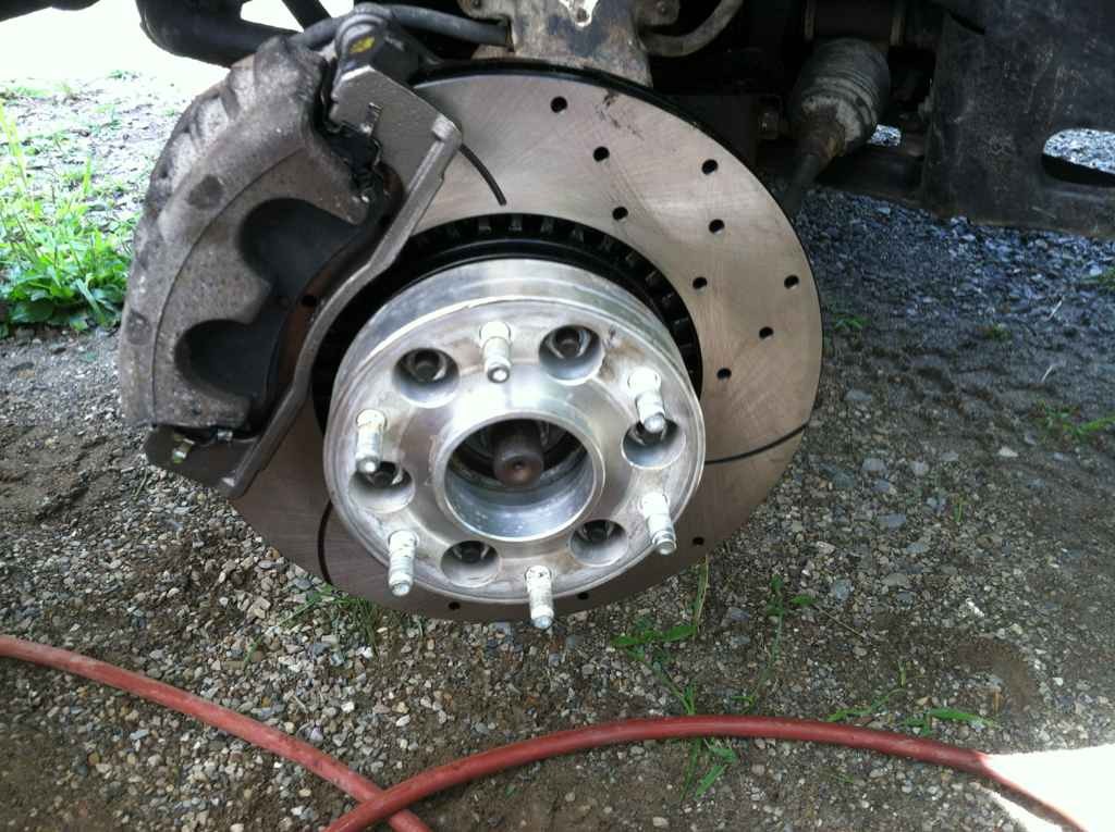

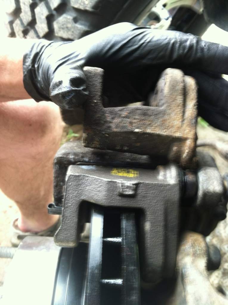

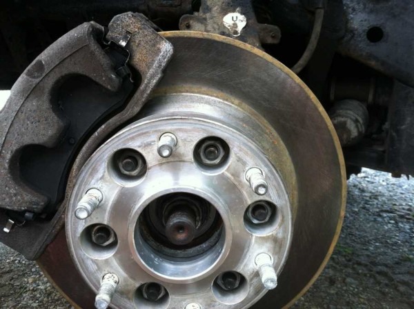

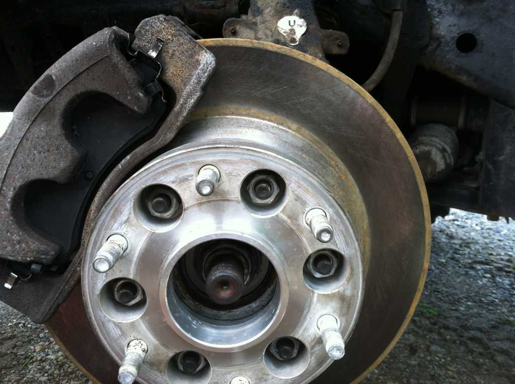

by Bcchevy » Sun Aug 04, 2013 3:27 pm
Did the ext brake conversion
Stock
These two rotors are for sale 50.00
Brand new 1 week old
Conversion done
Different bridges

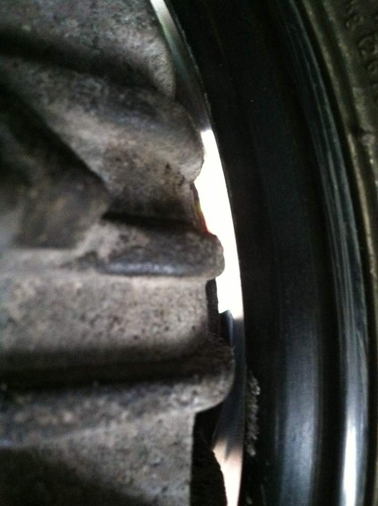

by Bcchevy » Sun Aug 04, 2013 3:43 pm
Shot of the wheel space between the rim

by v7guy » Mon Aug 05, 2013 12:56 am
what size tires and wheels did you end up with?
by DirtyBacon04 » Mon Aug 05, 2013 3:34 am
For an ext mod, you have to have at least 17" rims, correct? Is it just the rotor and bridges that get switched? Caliper and pads remain the same, right?
by Moots1288 » Mon Aug 05, 2013 6:44 am
DirtyBacon04 wrote:For an ext mod, you have to have at least 17" rims, correct? Is it just the rotor and bridges that get switched? Caliper and pads remain the same, right?
it could be 16s with the right back spacing, and the rotors and the caliper bracket are the only pieces that are replaced.
by v7guy » Mon Aug 05, 2013 8:06 am
Matt nailed it. It may be possible with the right backspacing, the only verified and tested combo is with 17s. That's why I was asking about his wheels cause he was talking 16s for a good while.
Since the caliper tapers down on the outside I would think that if the inside of the rim stayed outside the high point of the caliper a 16 could work. The tires would definitely stick out a good bit though.
