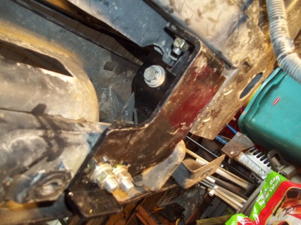

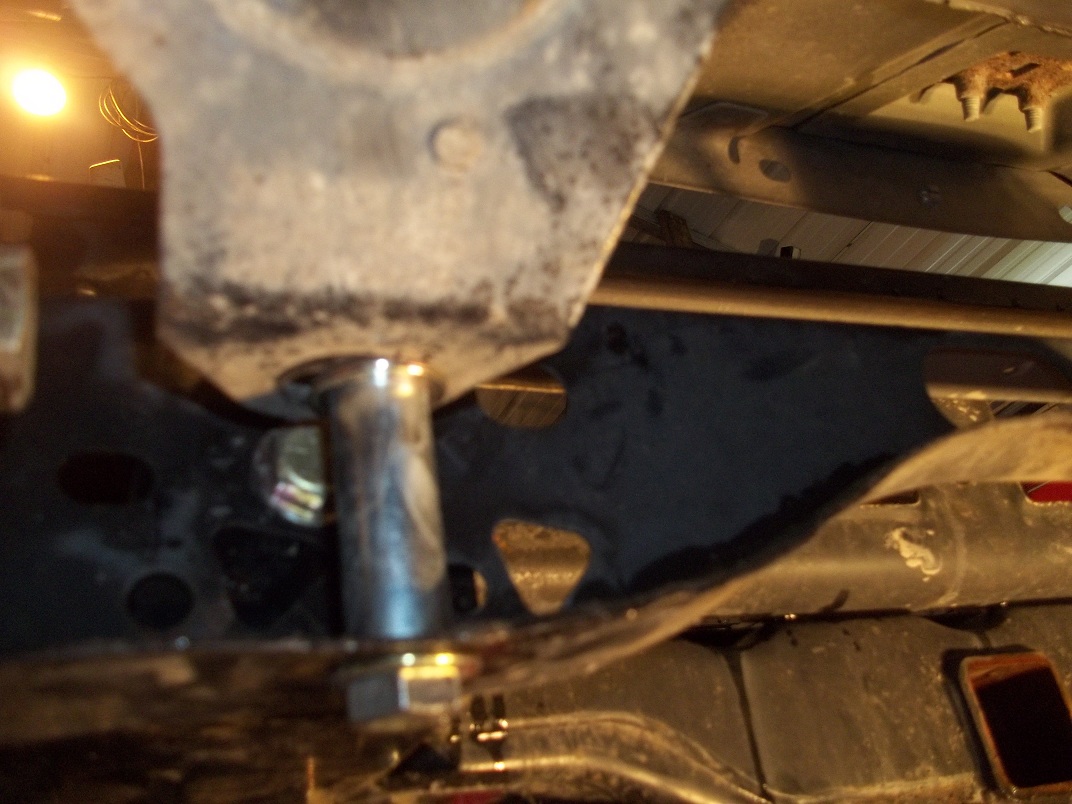

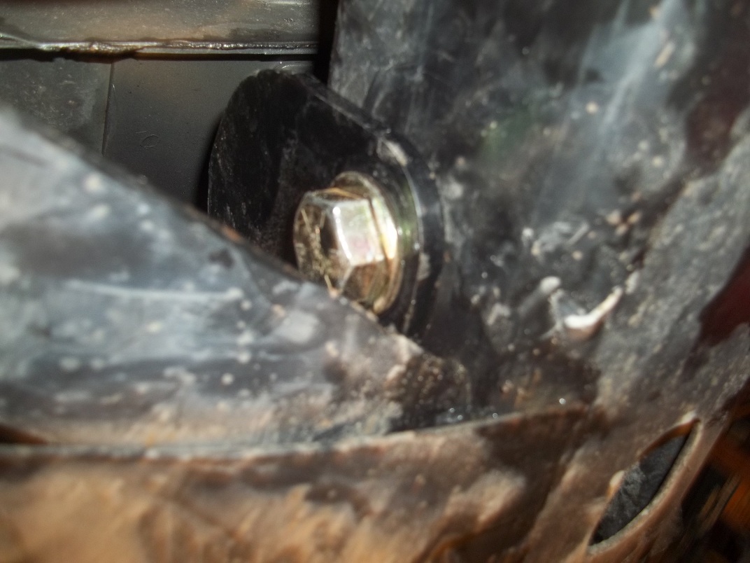

I didn't take a bunch of pics, just some things that I got stuck on or thought might make it easier next time. I'm not sure if I'm just not great at following directions or if Zone's directions just suck but I had a hard time with the bumpers.

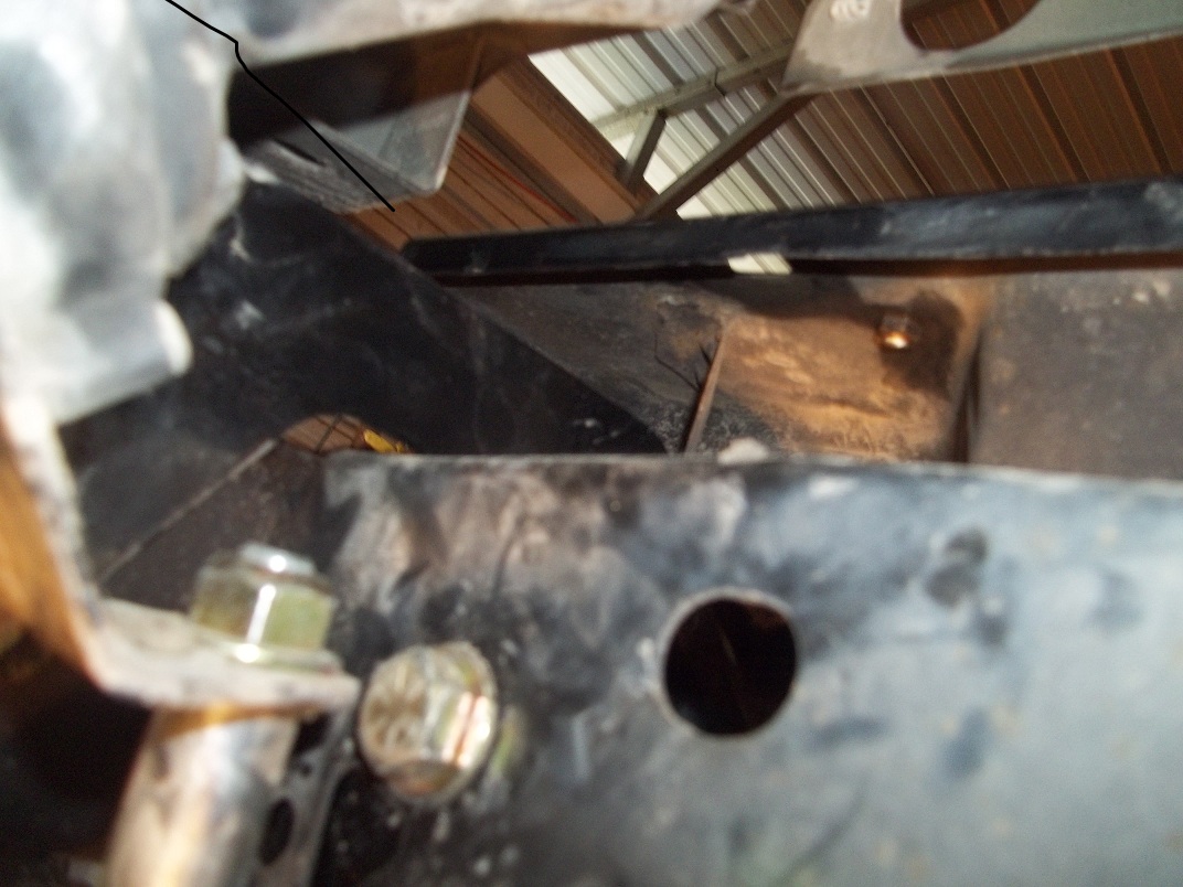

This is pic of how the front plate mounts to the frame and to the impact bar in the front.
It is upside down.

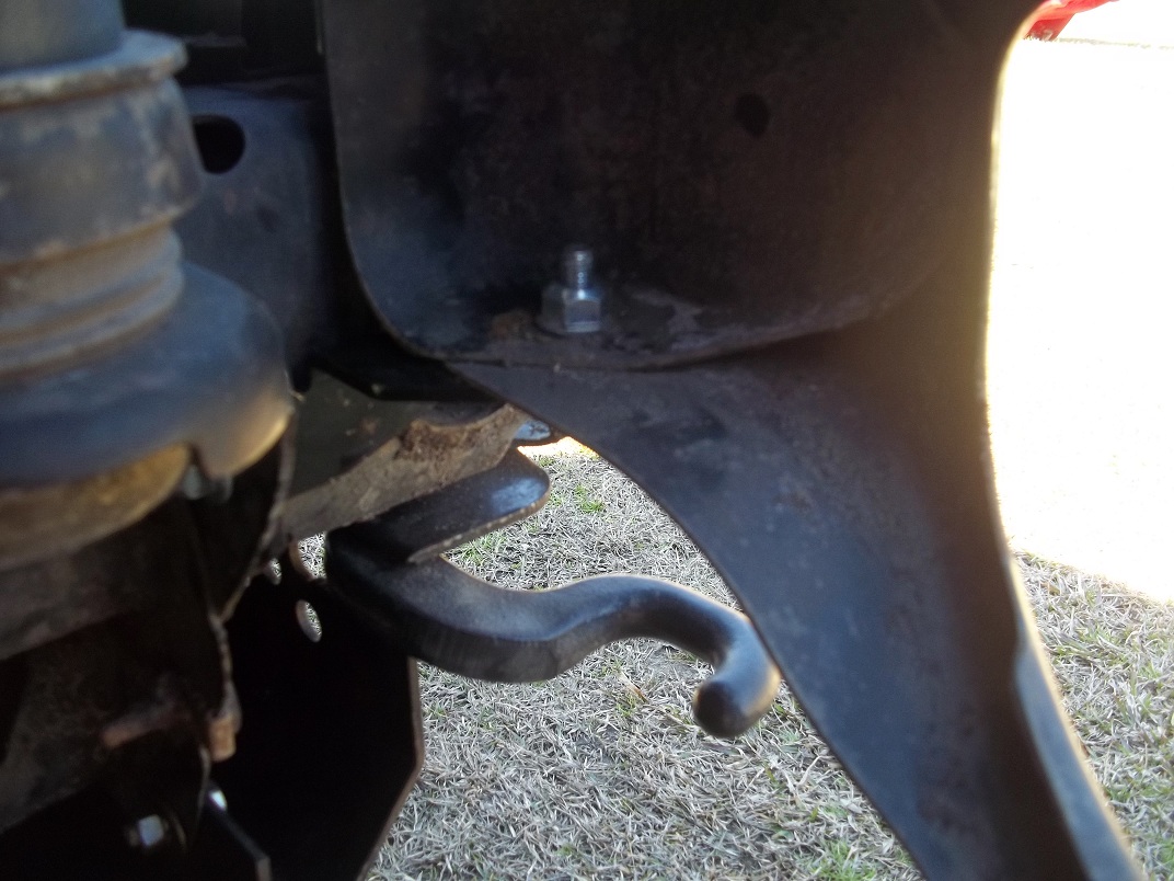

This is a pic of it installed from the passenger side.

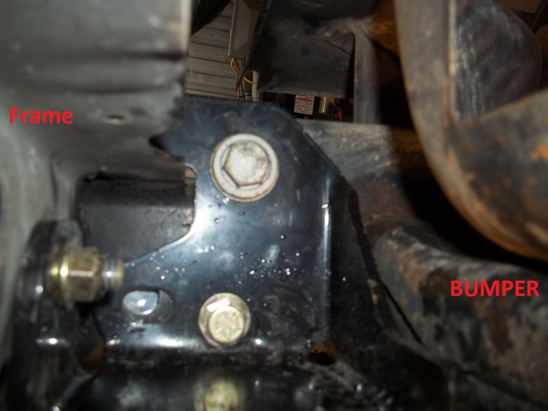

Moving to the rear bumper now.

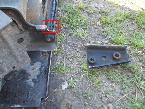

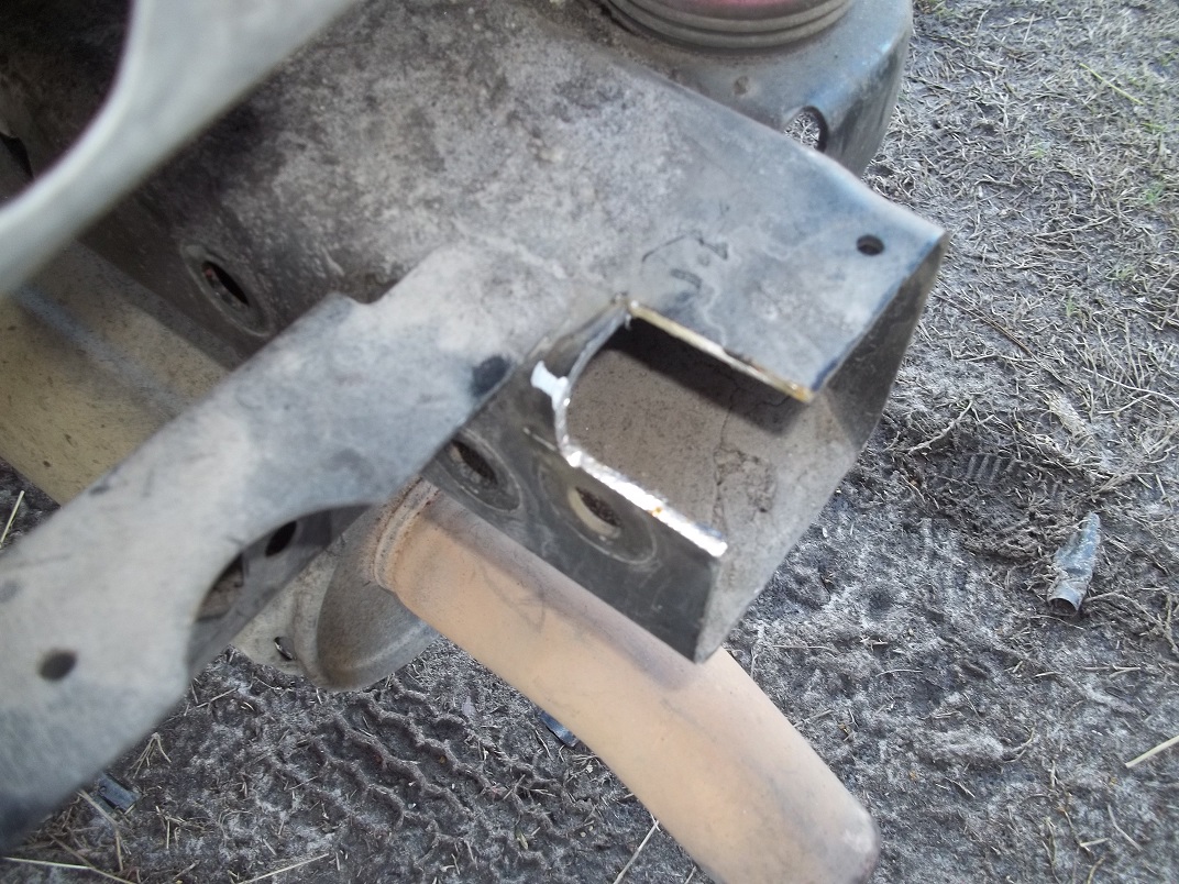

It took me awhile to realize you actually have to cut the bumper rails off.
I initially cut out a notch (in red) based on how I pictured it from Zone's images.
That notch is not necessary :-)
You do however have to notch out the rear frame tube on both sides.
When drilling out all those holes make sure to drill the hole out liberally, it will make it all go together that much smoother.

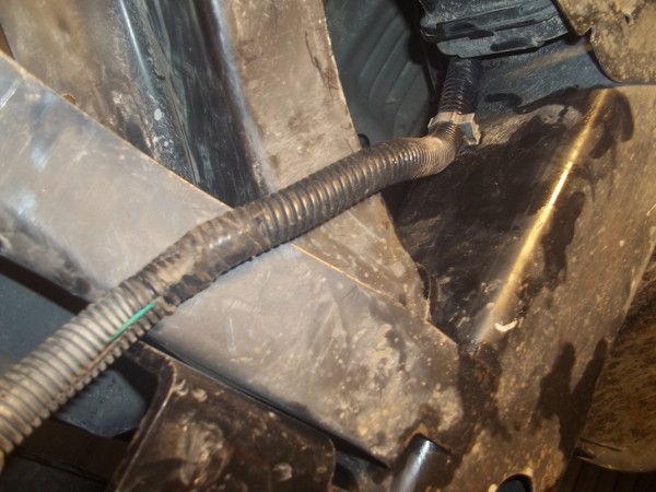

I found I had more slack running the wiring under the frame than running it over the frame like it was.

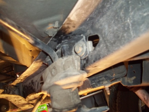

this is the front frame bolt on the driver side. The factory bolt is 21MM and a pain to
get out. The replacement is a 24MM bolt which I don't have a wrench for. It is much easier to get to after the lift. If i had it to do again, I might wait to get that bolt out after the lift was installed.

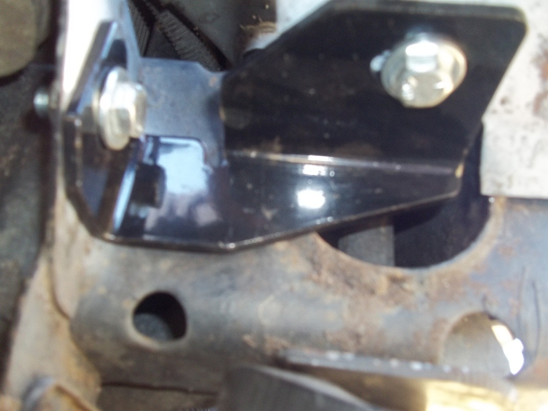

I guess this is the tire winch relocation bracket.
I installed it best I could by the directions. I ended up having to drill out the bracket to accept the factory bolt.

after reviewing the instructions over and over it looks like the winch part of the spare tire doesn't get relocated, only the crank part.
This is a pic of the crank part with the new bracket installed.
here is a pic of the lower mounting point with the the relocation spacer.
a pic of the winch back in it's original location.
Driver side bracket in place.
Passenger side bracket installed.

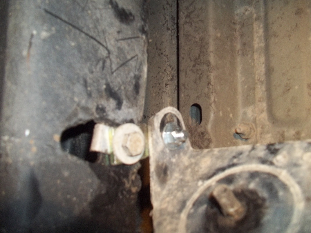

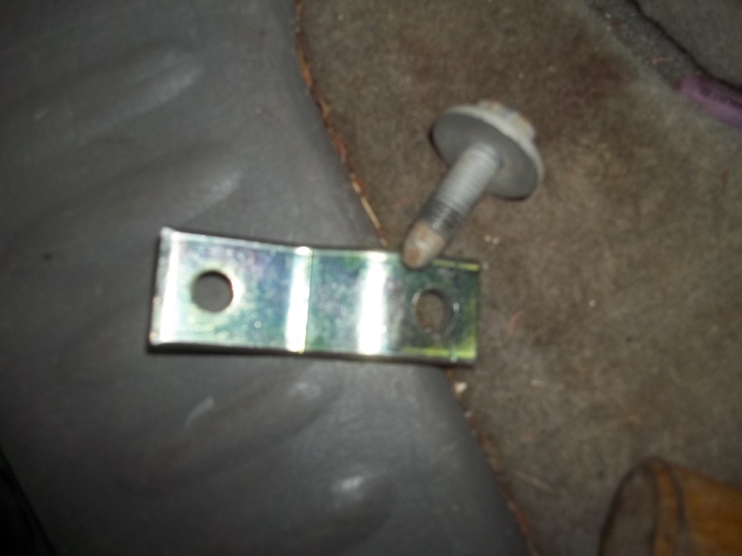

Make sure when you are tightening down the nut strips that their flap doesn't interfere with the other bolt holes. This is one spot where another set of hands would have been really nice. One to turn the bolt and one to hold the nut strip in place. In the previous pic you can see the nut strip covering one bolt hole. I had to loosen the bolt up enough to move the nut strip to put the last bolt in that I missed.

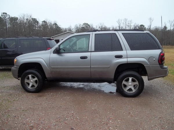

Finished install still sporting skinny (30") tires.
by HARDTRAILZ » Sun Feb 24, 2013 3:16 am
What wires are under frame now?
by Regulator1175 » Fri Mar 01, 2013 11:03 pm
It looked like the trailer harness.
by JorDaneeKey » Thu Mar 07, 2013 7:15 pm
I was wondering what ours would look like if we do the body lift this weekend. Those 30in tires look hilarious. Guess we'll have to chuckle for a while until we get the new rims and tires to replace our 30s.

yours will look even goofier because I only have the 2" BL and 2.5" suspension lift.
