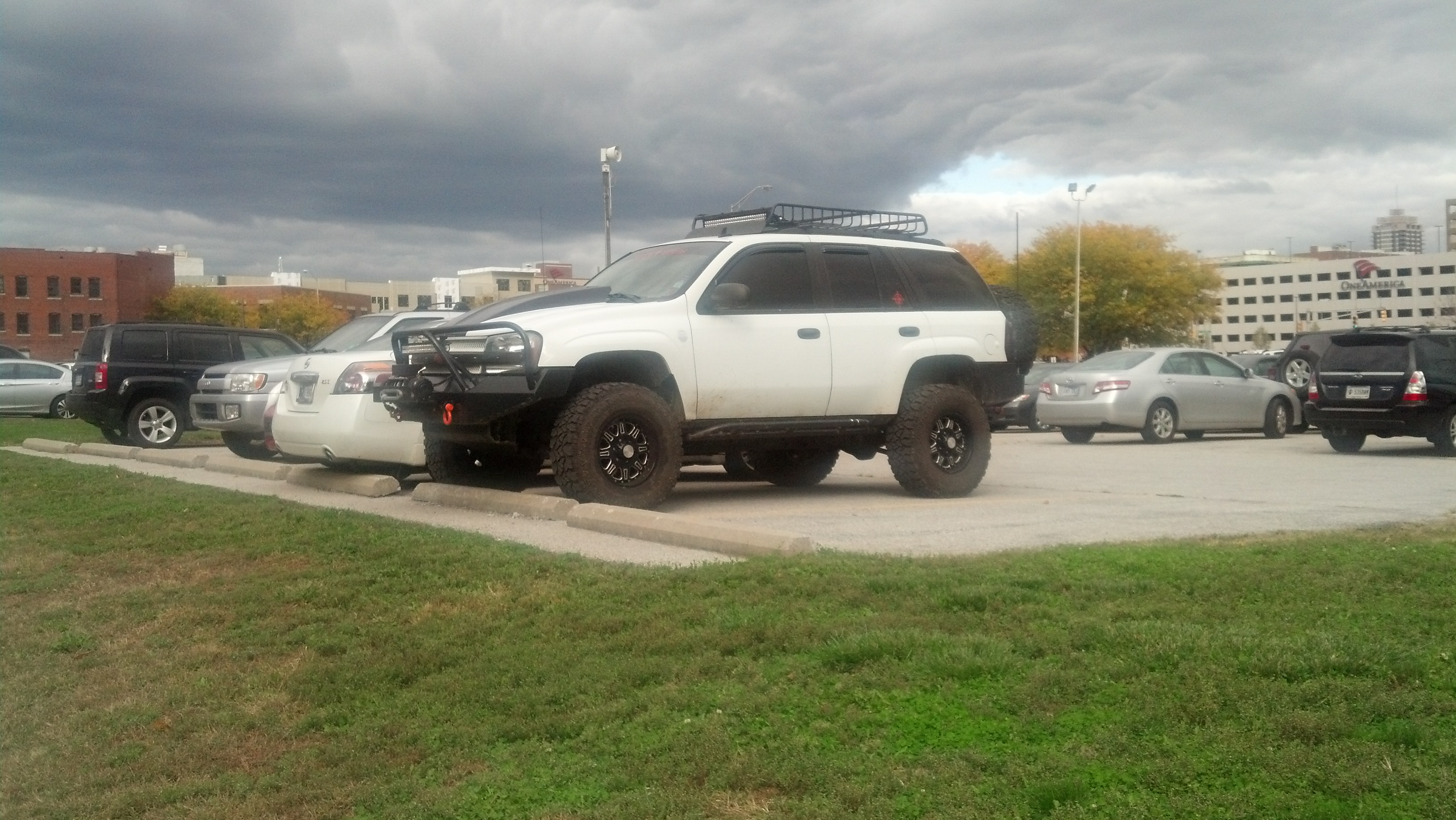

by v7guy » Mon Nov 17, 2014 7:30 am
My envoy runs 33s and no body lift, it works fine.
