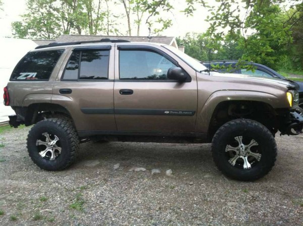

by Bcchevy » Sun May 26, 2013 10:01 am
Body lift installed
Gonna start on suspension today

by v7guy » Sun May 26, 2013 10:56 am
looks mighty fine. Might want to iron that fender, it looks a bit wrinkled lol
by Bcchevy » Sun May 26, 2013 11:03 am
Yeah 10-4 on the fender

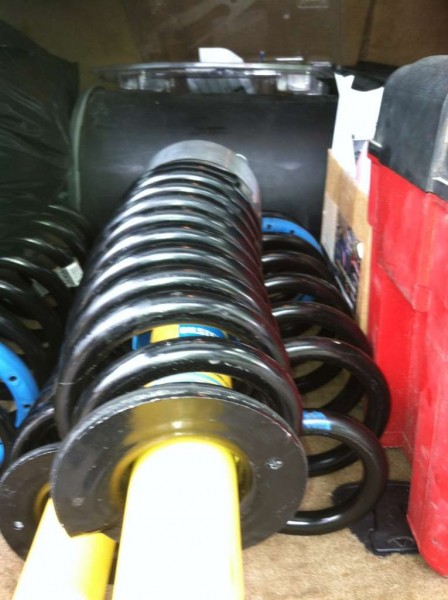

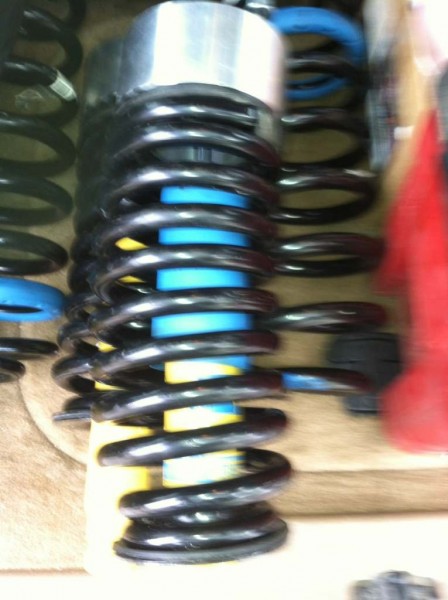

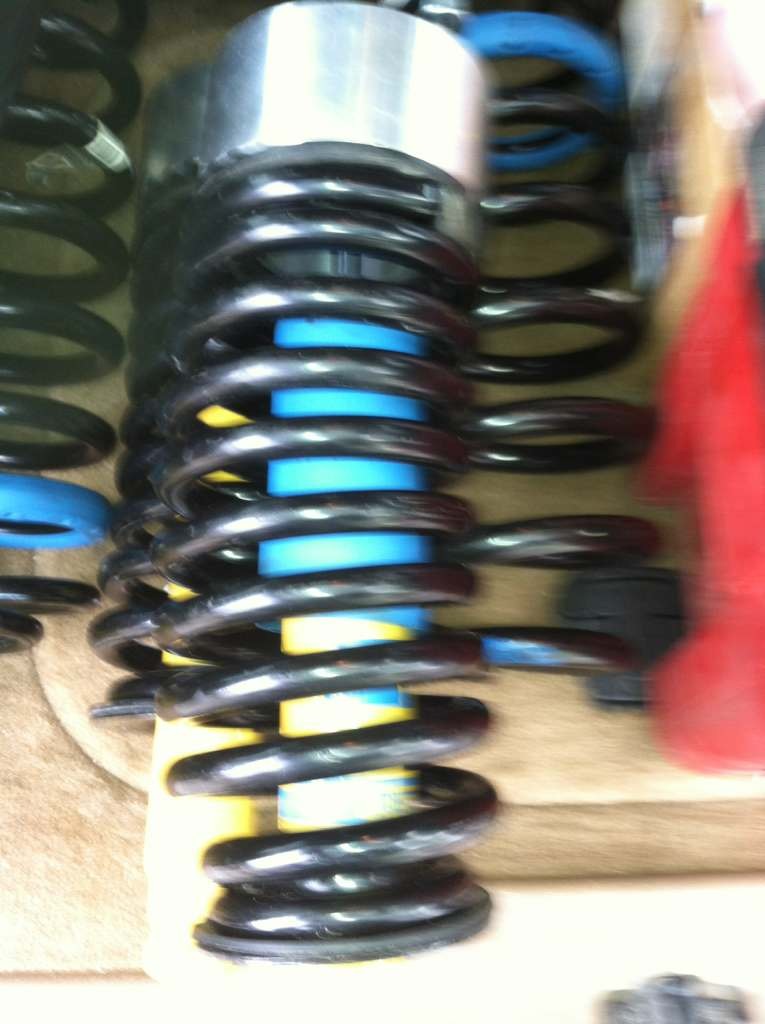

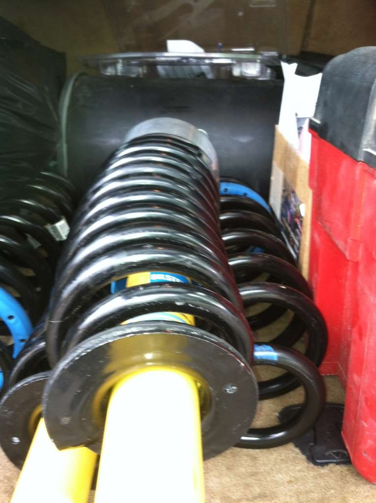

by Bcchevy » Wed May 29, 2013 10:40 am
Guys take a look at these
Should I run them or get different springs

by Bcchevy » Wed May 29, 2013 3:48 pm
see lot of views but no opinions
guess ill throw them in tonite and see what happens

by jonbo2002 » Wed May 29, 2013 3:54 pm
I viewed but don't have an answer, infact I am waiting to see what is said about your struts. It dosen't look right at all to me, but I have yet to install my lift I just got.

by boog2006 » Wed May 29, 2013 3:55 pm
Mine did the same thing...had a little rubbing but no issues so far.

by Bcchevy » Wed May 29, 2013 4:22 pm
Cool thanks man little piece of mind

by fishsticks » Wed May 29, 2013 4:37 pm
Looks like the rod nuts need tightened down more.

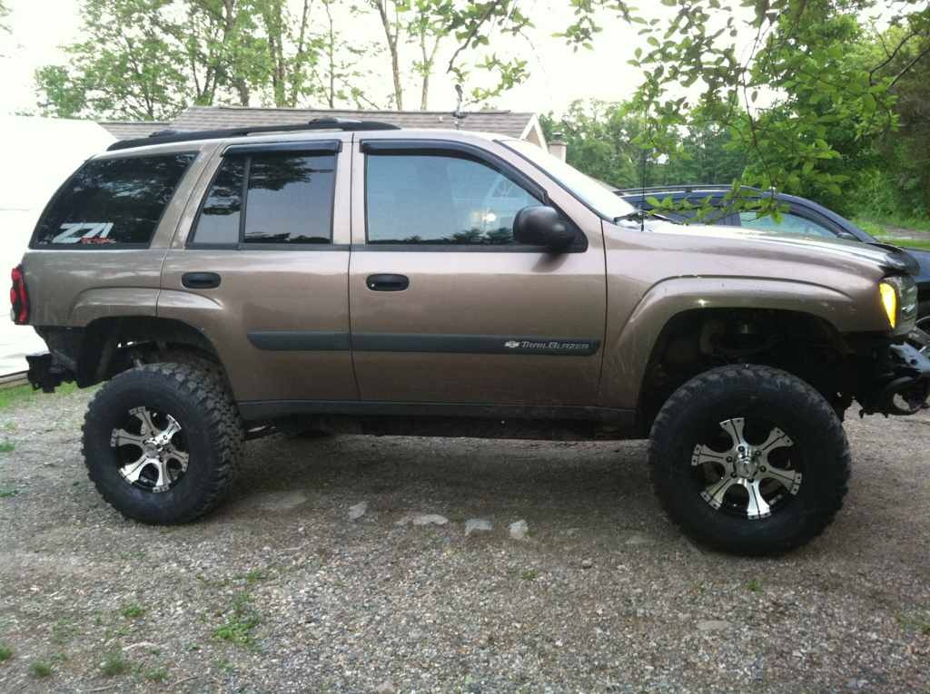

by Bcchevy » Wed May 29, 2013 9:11 pm
Are you talking for the mount on the end of the rod
That f-er is tight as tight can get

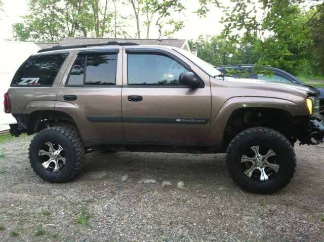

Here she is as of twenty mins ago

by ErikSS » Wed May 29, 2013 10:41 pm
Man, it's like we built our trucks together. lol I was reading each of your posts as I was building mine. Looks good man! How do you like driving it lifted?
by Bcchevy » Wed May 29, 2013 10:52 pm
Thanks Eric I been checking yours out as well! Kinda jealous of the ss tho...
Not bad went for a quick ride to the deli and it was cool.
The z71 and the moog 81114 springs are a little stiff right now but I plan on doing bumpers so that should help.
I still have a bad bushing on the lower control arm and want to do the outer tie rods before I get it aligned
Gonna try to do that this week and get it aligned on sat
I keep ya posted
And good luck with yours

by v7guy » Thu May 30, 2013 8:06 am
my 89s had a bit of a bow like that, they partially straighten out as I drove it a bit. I've never seen them perfect. couldn't tell ya one way or another if they'll be fine, but I've destroyed three shocks to date, one before the bumper and two after. In fairness one of the shocks got bent because I didn't keep up with bushing replacement on the upper mount.
