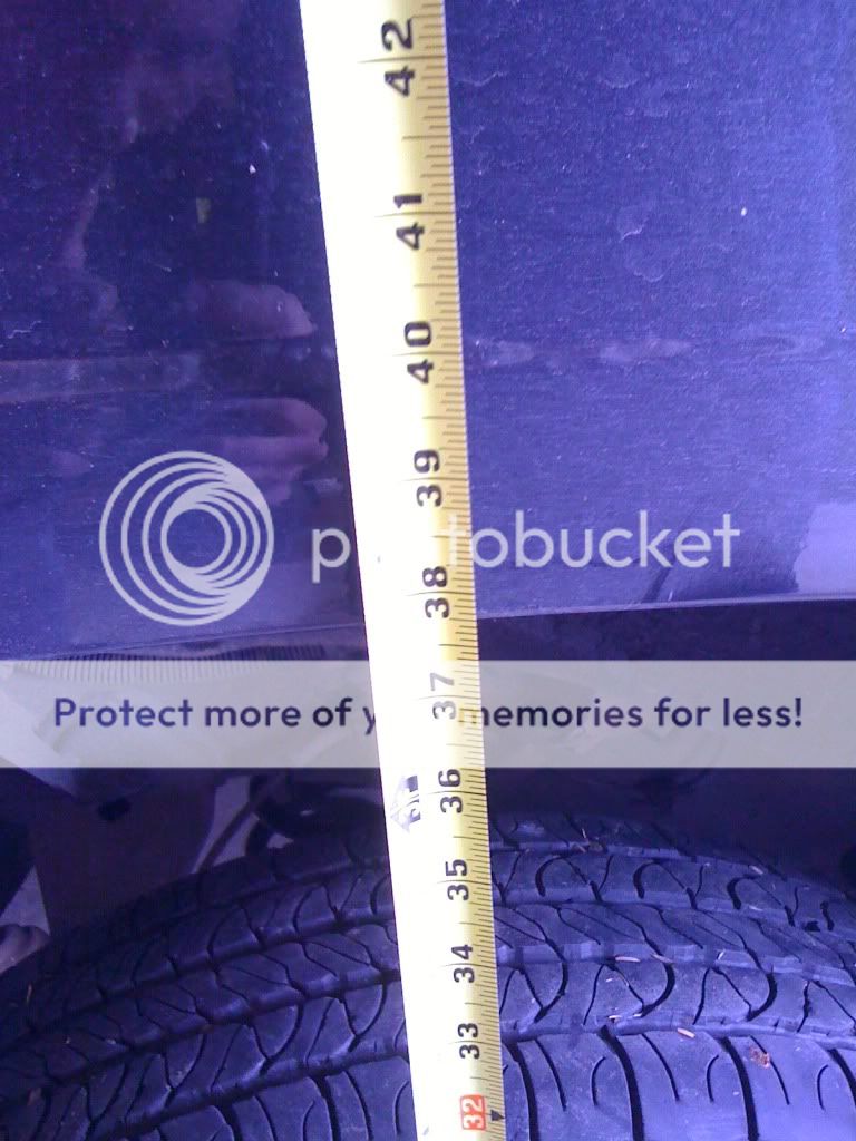

Link to my Build Thread in my previous post. I just updated that to reflect the suspension mods and added a current picture. I'll post a couple more I took while doing the lift... Unfortunately, I completely spaced taking pictures before I started the rear, and of the stock Air Springs coming out. :wallbash:

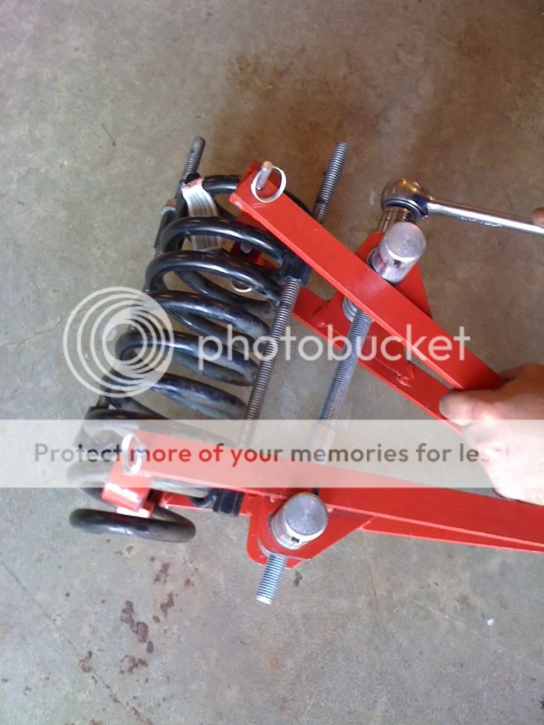

Had some issues with the small spring compressor, so we put the big one on to compress, then held it with the small one while we did the work.

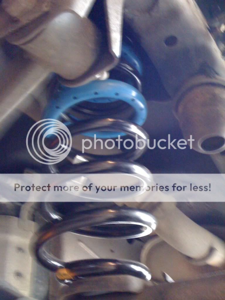

Rear Z71 Springs going in...

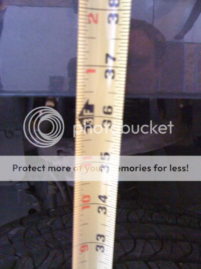

This is the drivers side measurements. Shows 3.75", but that wasn't settled. After driving a while, it sits at 2.75" even on each front. Need an updated picture...

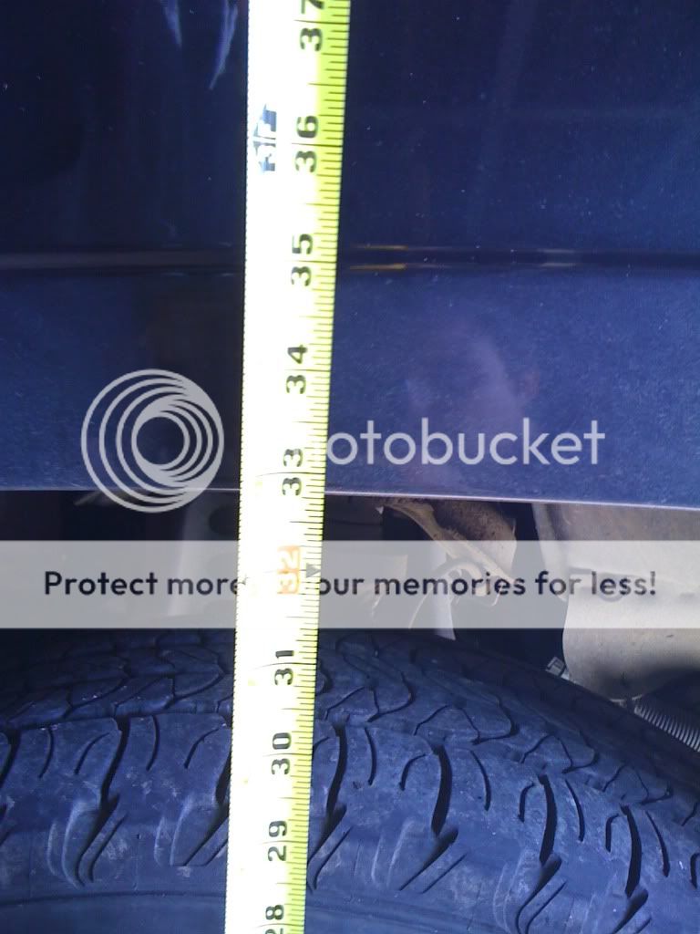

If I remember correctly, the back was sitting at a little over 34", so somewhere around 3.5" lift.
Finally, a before and after...
