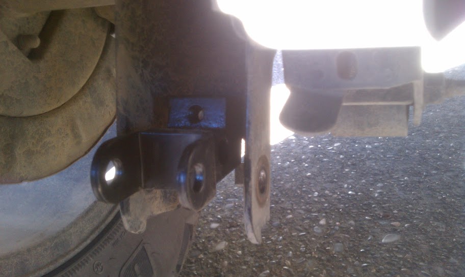

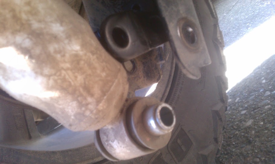

Back to the rear shock topic... keep in mind that wide body shocks (like the later BDS design) rub on the panhard mount when the rear axle angles down towards the driver side. Teebes and I both have this problem and anyone who's run the wide body rears with disco'd/no rear swaybar should check for this. a longer shock than the BDS will only make this problem worse as the maximum angle the rear axle can take increases. The solution is relocation, which is why I was looking at the XJ brackets.
by HARDTRAILZ » Tue Feb 01, 2011 5:28 pm
UPt a similar product..rockstar??? Relo and high clearance brackets on a JK a few weeks back. They relocated and you cut off the old brackets for clearance but they still bolted on. I will ask my buddy about them.
by Trail X » Tue Feb 01, 2011 5:30 pm
Those look rattly... someone should try re-drilling their lower mount holes. There appears to be room to move it up by an inch or two... then you can grind off some of the hangy-downy metal.
by fishsticks » Tue Feb 01, 2011 5:31 pm
JamesDowning wrote:hangy-downy metal.
This is one of those technical ME terms, huh?
:poke:
by janesy86 » Tue Feb 01, 2011 5:33 pm
Haha, thats a pretty good idea JD. I'll take a peek soon.

by Gordinho80 » Tue Feb 01, 2011 5:43 pm
Tomorrow, I'll be drilling my lower mounts. JD had mentioned this before and I had intended on doing it when I got the BDS's... was just too happy to have new shocks then and skipped it.
I'm going to try to go up 2"... should be enough rooom

by Zero » Tue Feb 01, 2011 6:19 pm
Id love to see more on the relocation of the rear shock by drilling a new mounting point a lil higher than stock.
I hate my z71 rear, cant wait to ditch it for skyjacker and rancho shocks.
Zero
Posts: 1048
by fishsticks » Tue Feb 01, 2011 7:28 pm
I was out so I stopped by the 4x4 shop and picked up a pair of those brackets.
They are TeraFlex P/N 1544790 for a 97-06 Jeep TJ (not XJ, my bad).
I mocked one up using the third bolt hole in our flange. There is a threaded hole in the back of the brackets for something similar on the TJ.
I'll have to redrill the flange like JD/Mario were talking about... but this looks promising. It looks like the shock will compress about 1.5-2" farther at rest, which should put it closer to where it was designed to operate.
I'll have to wait until I'm ready to commit to this since the hardware used to adapt the BDS shock to our flanges is bent to hell on mine and won't be coming off without being cut.
