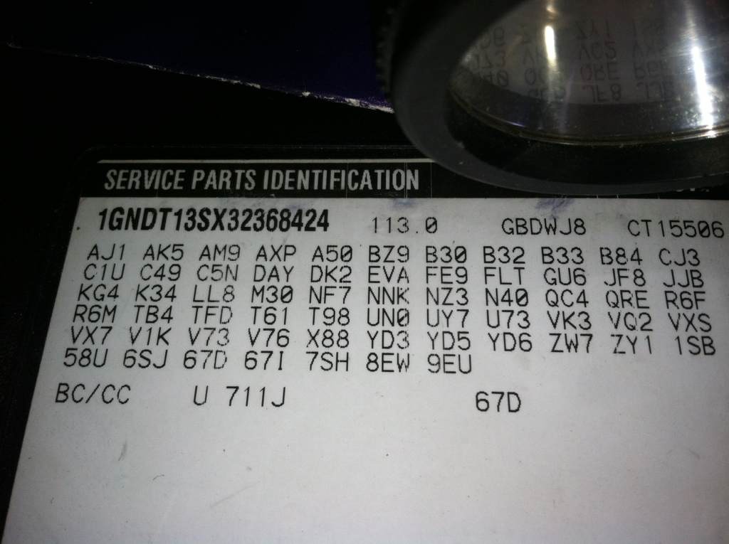

Yeah I read that one last night lot of great info but I don't know which code is my front springs on the tag in the glove box. I looked on the spring as well and can't find a color or a stamping. I don't see any codes that match mine exactly and as far as which code it is...

by Trail X » Tue May 07, 2013 11:02 pm
There were a lot of them, especially in the early years, and they somewhat consolidated later. You can almost bet that you got 93s if you have a swb 4x4. Rough estimates like that are in that thread if you read.
by Bcchevy » Tue May 07, 2013 11:28 pm
It was one of the last post you made on there! I found it 83's. Fell asleep last night reading it! Guess I didn't gt all the way thru,
