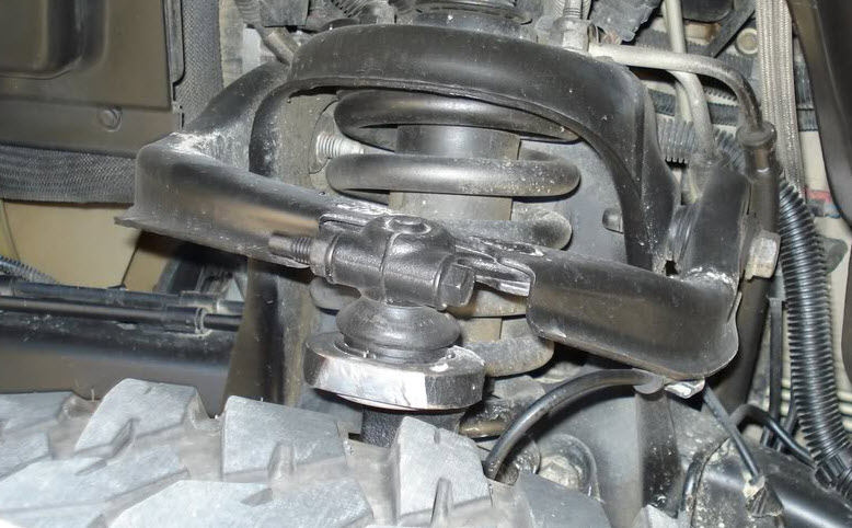

by bpdski » Fri Mar 29, 2013 2:06 pm
Maybe I described it wrong. This is what I was referring to.
http://forums.offroadtb.com/viewtopic.php?f=14&t=2065

bpdski wrote:Maybe I described it wrong. This is what I was referring to.
Flip the Upper Control Arms, but don't grind them. To fit 31.5s as you are looking to, a suspension lift and a spacer/adapter will work.

by The Roadie » Fri Mar 29, 2013 3:07 pm
Man, 20 seconds with Google image search found me this one. :finger:
Posts: 5012
by navigator » Fri Mar 29, 2013 3:11 pm
the link the OP posted previously has pictures of Beamer's rig with them.
my 30" tires were close to hitting the UBJ, I don't see how a tire over 31" fit safely.
by Conner299 » Fri Mar 29, 2013 3:28 pm
The Roadie wrote:Man, 20 seconds with Google image search found me this one. :finger:
No $hit!!! I stand corrected... My apologies. I just dont see how this could be considered worth doing though.

mikekey wrote:I suppose it'd be worth it if you where that concerned with bumping it.
Theroretically, though, don't you make that area weaker, by grinding it down? I would rather have spacers, and possibly have my wheel bearings fail a little early, than lose my upper steering knuckle.

by Gordinho80 » Fri Mar 29, 2013 4:42 pm
My UCA broke without any grinding, but it broke on the inside... I don't really see an issue with grinding down the outside lip a hair. Would I do it? NO. I'd go with a better lift and spacers.
