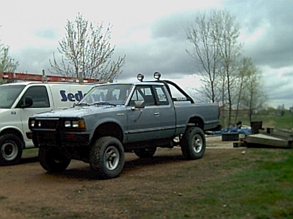

Personally, I don't want a strictly on road truck but I don't need a total trail rig either. The lift isn't cosmetic, it will be enough to get a set of real tires under it and make the truck capable of going where I go. More lift than what your tire needs is a waste IMHO because it just raises your center of gravity but your axles clearances are not any better, no good for a on road or trail truck. Right now I think a longer front springs with the same spring rate as factory sounds perfect for the direction Im going with room to grow. Added spring rate in the rear will help with my towing. Heres a couple pictures of my old Nissan IFS, it was fun but I broke front end parts more than my solid axle trucks so I'm keeping the trailblazer modest. To each their own :cheers:

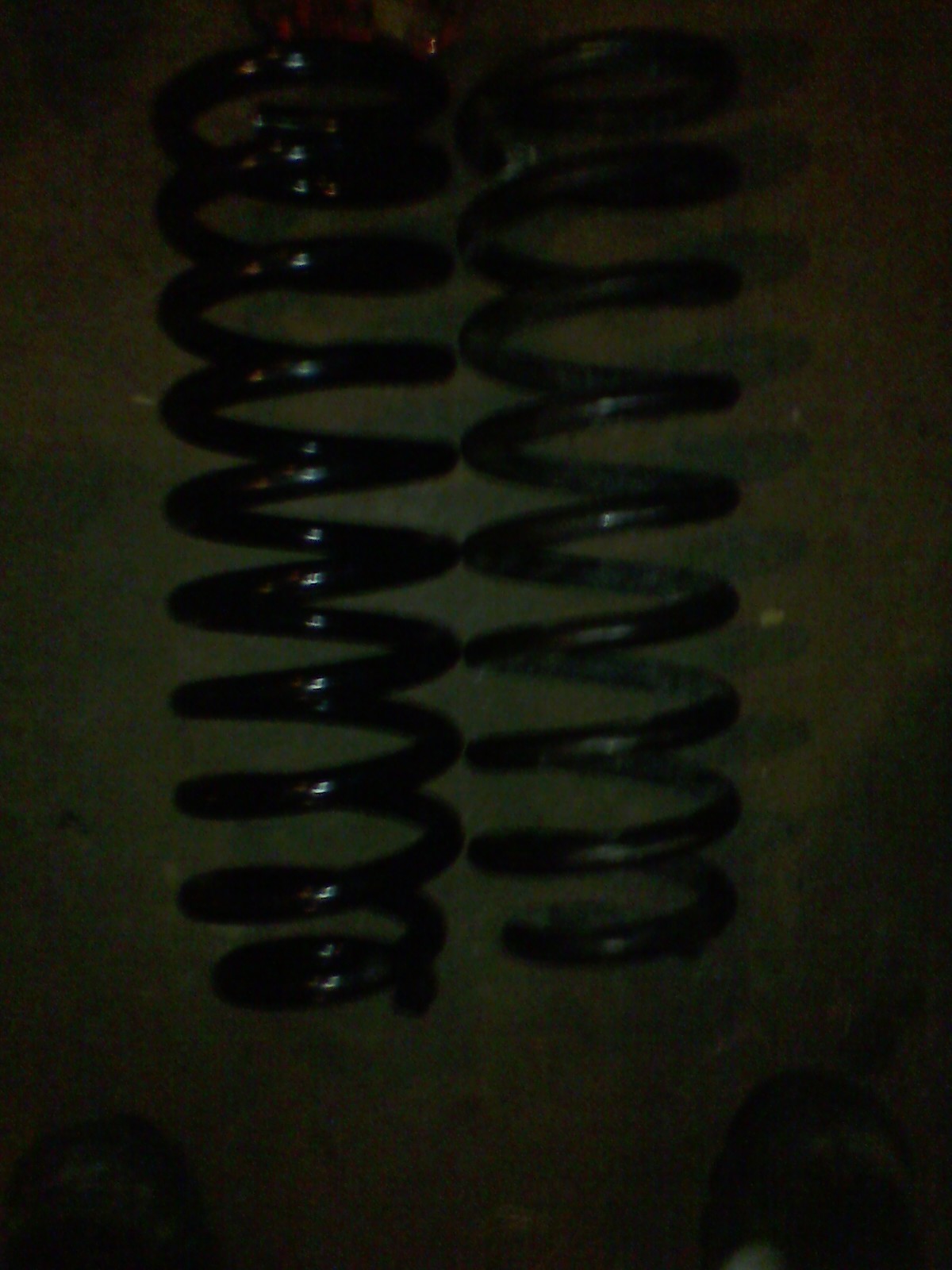

Installed! Got 2" in front with the 81114's with marks 1/2 spacer above the strut. Expecting it to settle a bit since the springs are new but I'm ok with that. The ride is unchanged if not alittle better than the factory suspension with 90k miles. The front fender is 35" from the ground and the rear is 34 1/4 with 245/65/17 tires. Had no binding at full extension from the cv axles, the limit of the ball joint seemed to be just a bit further than the limit of the strut. It still has the 81071's in the rear but the 81069's are in the mail and should be installed by next weekend. That should give atleast an inch in the rear. Ill take some pictures of the truck after those are in but I did take a quick picture of the 81114's compared to the factory 85's, sorry about the quality but I was too busy with the install to get a real good pic. As you can see theirs more coils on the moogs and about an inch longer. It was pushing the spring compressor pretty hard to get them to an install height, would had been tough to get more to get a spring spacer in there. With plenty of breaks it only took 5 hours thanks to all the info I had gotten here on what issues to expect and how to handle them.

So far it sounds like what your doing is exactly what I had planned. The Moog springs, slightly stiffer compared to your old 85's should be perfect in place of my original 83's with 186k on them.
