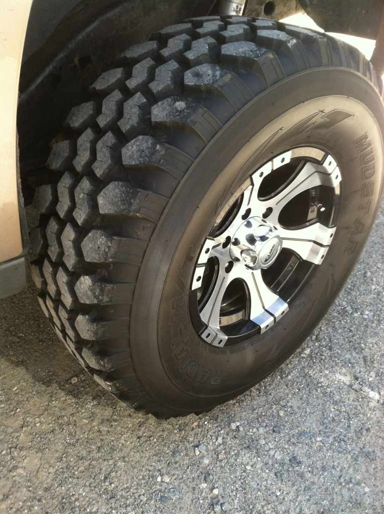

v7guy wrote:Matt nailed it. It may be possible with the right backspacing, the only verified and tested combo is with 17s. That's why I was asking about his wheels cause he was talking 16s for a good while.
Since the caliper tapers down on the outside I would think that if the inside of the rim stayed outside the high point of the caliper a 16 could work. The tires would definitely stick out a good bit though.
I believe Brian told me he was running 16x9

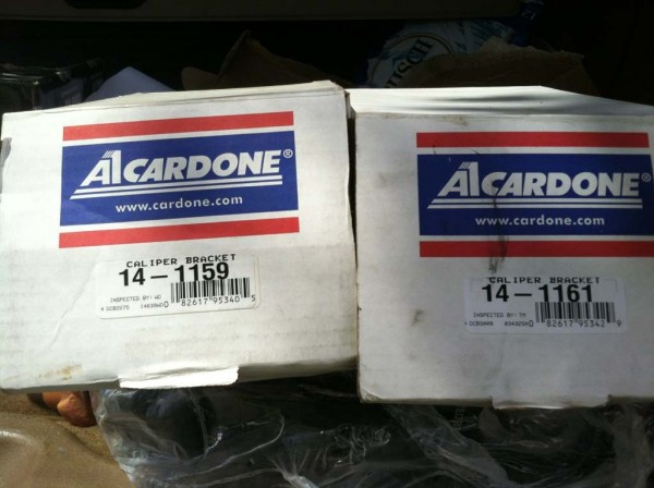

I am running 16x8 alum 4"bs with marks adapters
Pads and calipers are the same
Bridges and rotors are from a ext

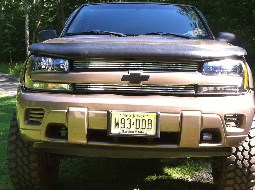

Did a little grille mod this weekend as well

What tires?
by Bcchevy » Mon Aug 05, 2013 12:08 pm
Lt305/70r16 mud stars 32.8 diameter
