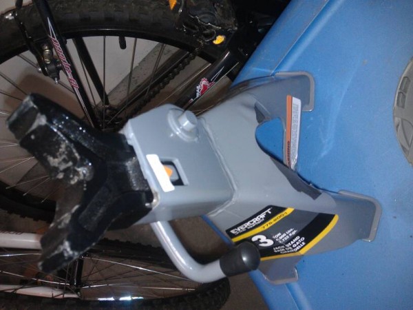

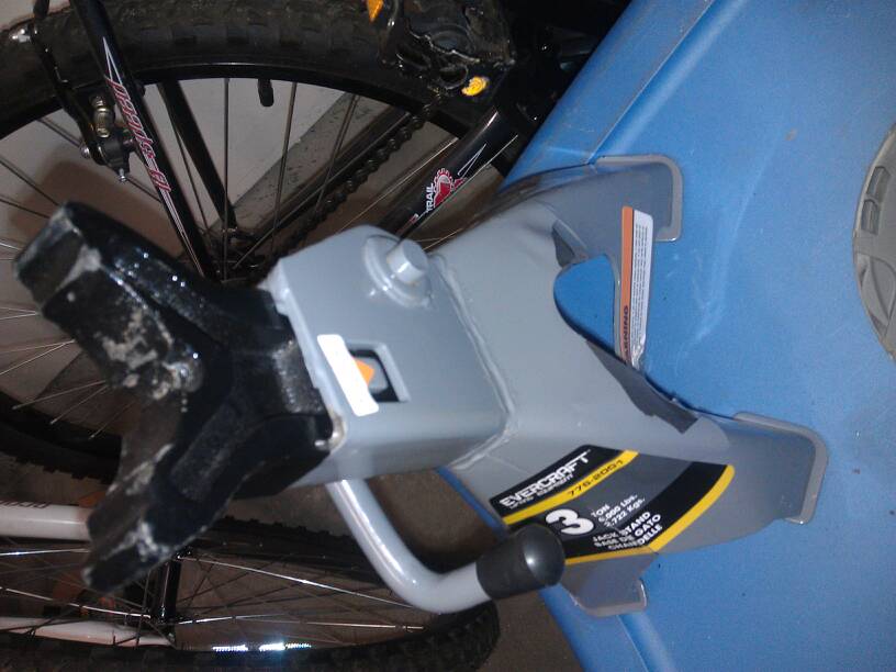

by AceOfSprings » Mon Jul 30, 2012 1:58 pm
Bah, just one problem after another. Just had an Evercraft "3 ton" jack stand buckle. Luckily I was not under the car because it dropped to the ground. Looks like nothing broke besides stand, but anyway im just need a break. Thanks fot all the help and advice though.

by Trail X » Mon Jul 30, 2012 2:42 pm
Wow David. Glad you weren't under the vehicle. Might want to contact the MFG, they will probably gladly replace it, since it was being used within standard operation conditions.

by Trail X » Tue Jul 31, 2012 12:43 pm
AceOfSprings wrote:
Sent from my mind
Were you by chance on a slope? Looks like the stand was maybe unevenly loaded?
by AceOfSprings » Tue Jul 31, 2012 2:15 pm
no it was flat ground. I was wrenching pretty hard though so there was a bit of forward pressure, that is what did it in.
