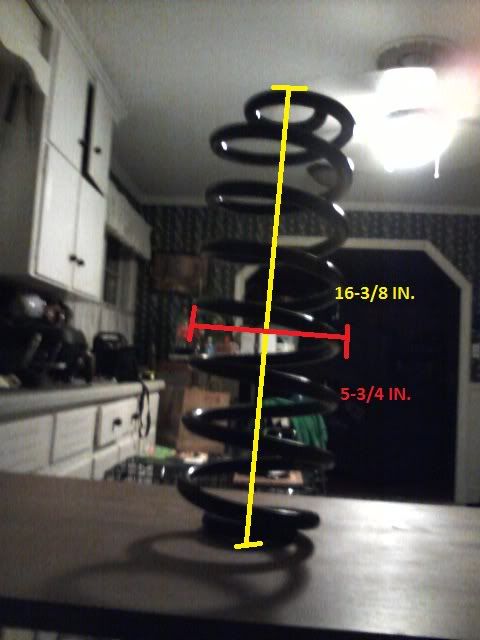

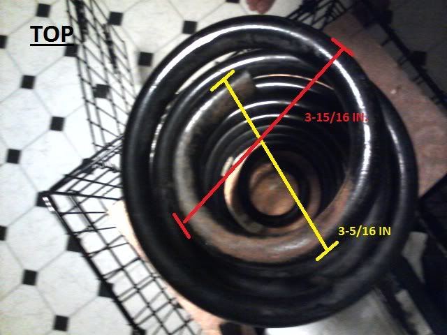

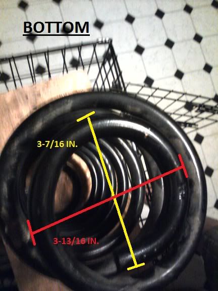

by NC_IslandRunner » Fri Apr 15, 2011 12:16 am
Rear stock coil spring I don't have the front off to measure.
The best measurments I could get from my old stock springs, they had over 100,000 miles on the so they maye not be perfect.
Hope this helps, maybe some else can measure the stock front for you.
