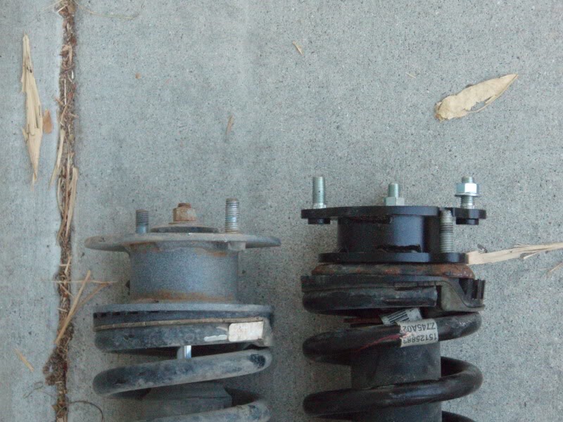

if your "kit" is outside the strut like below do not use and return because you damage your front end because of this much cv binding . left inside the strut, right outside strut. thread below about ready lifts version.
viewtopic.php?f=15&t=83&start=0

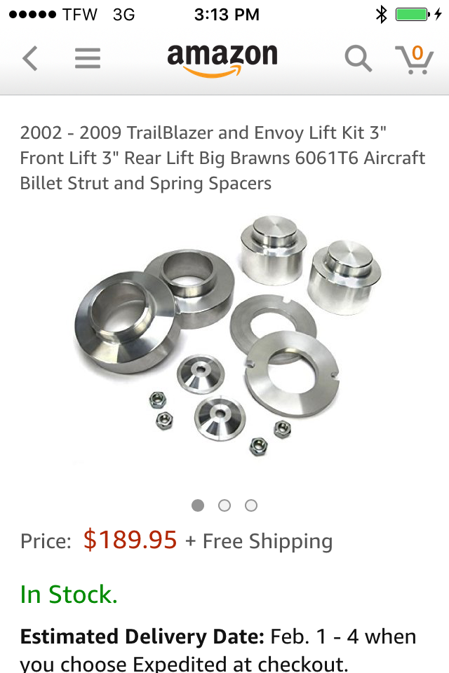

This is the kit off amazon I bought
This is what I bought
Trailblazer1
Posts: 6
Joined: Sat Feb 27, 2016 10:41 am
by TBYODA » Sun Feb 28, 2016 8:38 pm
that's a copy of MarkMC 2.5" lift kit
