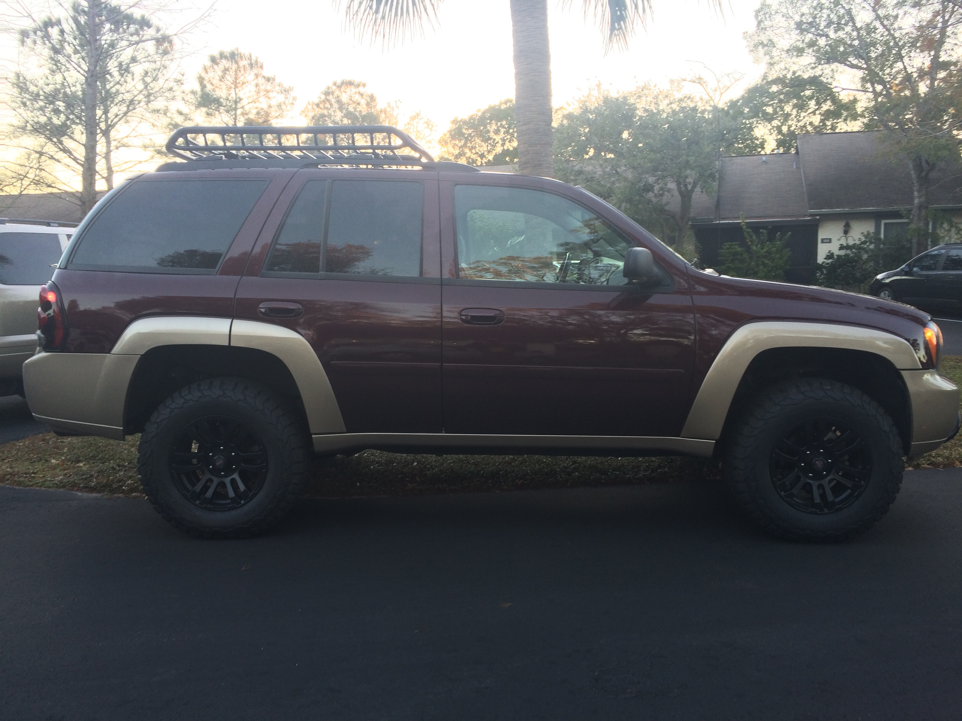

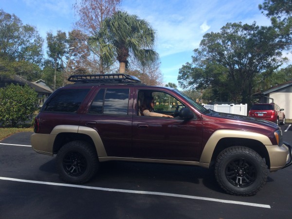

There isn't much info available on this combination and just wanted to let everyone know I am super happy with the results. The build is as follows:
-Front: Moog 81112 springs, Bilstein HD struts and Markmc 2.5" lift kit spacers (Approx 3.5" of lift)
-Rear: Moog 81069 Z71 replacements, Skyjacker N8030 shocks and Markmc 1" rear lift spacers (Approx 2.5" of lift)
-MB TKO wheels with +25 offset and 265/70/17 BFG Ko2's
